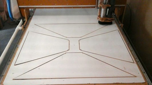

      The sanding table's "Funnel" caused me the most consternation of the whole build until I had an epiphany one morning at 3am.
      I drew out my rectangular cone shape using an old CAD program that only ran on an old ibook that required my booting it up with an even older operating system. (I've tried newer different brand programs, but my shriveled brain just can't figure them out.) Anyway, I was able to create my extruded shape and get all the weird angles I thought I needed as well as the dimensions of the length (depth?) of each trapazoidal shape.
      Then I changed my cabinet's dimensions. I wasn't sure I could go through all the gyrations of the CAD program again to get new measurements.
      That's when I had my epiphany and remembered my tenth grade geometry: A squared plus B squared equals C squared! A right angle triangle! I had measurements for A and for B; what I needed was C, the hypotenuse. Finding the square root of a number used to be hard; now we have calculators!
      1. Just to be sure things would fit, I cut out a full size mock-up in cardboard.
      2. Determine your measurements: My cabinet's inside length and width are 42-1/2" x 24-1/2". I want the depth of the funnel to be 10". I want the bottom flat (where the vacuum connects) to be 8" square.
      3. So, I want "C". "A" is 42.5 minus 8 divided by 2; equals 17-1/4". "B" equals the depth; 10".
      4. Therefore "C" is 19-15/16" for two of the funnel's trapezoids: 8"x 19-15/16" x 24-1/2". Dimensions for the other two are: 8" x 13" x 42-1/2".
      5. These pieces are shaped like isosceles trapezoids, with the perpendicular distance between the two parallel ends being "C".
      6. Looking at my drawings, there are 7"x1/2" tabs at the narrow ends of each trapezoid. This 1/2" is in addition to the length "C". These tabs will fit into slots cut into the 9" square.
      Cut out your funnel:
      1. The CNC made light work of this for me, but laying out the patterns full size and cutting with a jig saw, etc, makes the work almost as easy.
      2. Clean up your edges with sandpaper or a surform
      3. I found I needed to chamfer the mating edges to keep within my dimensions. I used a 45° router bit on the router table to achieve this. 45° is too much of an angle but it worked ok.

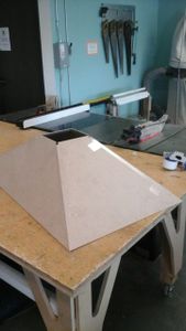

      4. Fold your sides into a funnel shape. Tape to hold in place.
      5. Hot melt glue or construction cement would be a good choice for gluing the sides together, but I didn't think of that.
      6. Lay out the 9"x9" square:
        1. You want a 4" hole dead center.
        2. From center, mark an eight inch square.
        3. From your taped or glued-up funnel, figure out what angles you need to cut into the square.-- One angle for the longer pieces and one angle for the shorter pieces. (Here's where you're going to have to dig up your Jr High math again. Don't you wish you had paid more attention in class instead of passing love notes to Mary-Jane or Billy-Bob {as the case may be}?)
        4. Cut these angles on the table saw; at the eight inch line, ±1/2" deep. They'll need to be a little "fat" so your funnel can slide in without too much trouble. (I'd give you these angles, but I forgot to take notes.)
      7. With your square done, fit it onto the funnel's bottom. Screw a couple of washer head screws through the panels & into the square.
      8. I used 1"x2" battens cut at (about) 16° to sandwich the funnel sides together. I temporarily fixed them in place with a brad nailer, predrilled screw holes, and then screwed the battens in place with the #6 Spax screws.
      Take your funnel and drop it into your cabinet. If you're lucky -- as I was -- it will fit snugly, otherwise you'll need to make some adjustments to get it to fit.
      Mark 1/2" from the top of the cabinet sides and screw the funnel to the sides. The washer head screws work best here too. They're less likely to punch through the thin panel walls.
      At this point, add some caulking around the top edges of the funnel and at the bottom where the funnel sides fit into the bottom piece.
      Screw the wire mesh over the dust collector hole. -- You don't want big pieces of debris getting sucked into the collector's fan blades.
      Finally, put the 2x4 frame back on the cabinet and screw it in place.
