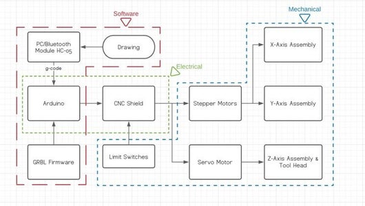

Step 6: High-Level Design
to design this robot we divided it into 3 sub-systems:
- Mechanical
- Electrical
- Software

Step 8: Circuit
The requirements for the electrical circuit are simple: the circuit needs to be able to drive the robot's axes in the x and y directions, move the tool head up and down on the z-axis, and be able to perform homing calibration independently. The circuit should also be robust and compact enough so it can be mounted to the robot base plate.
- The CNC Shield is attached to the Arduino and Stepper Motor Drivers are inserted into the X and Y axis slots and the Bluetooth Module draws power from a 5V pin on the Arduino that is left unoccupied by the CNC Shield.
- For the Protoboard, a normal board was used. The connectors soldered to the board are Dupont Female Headers for connections to the Arduino and JST XH Female pins for connections to the robot hardware for robustness, although Dupont headers can be used.
- The endstops are wired to be in the NO (Normally Open) configuration, although if the user prefers, they can be wired in the NC (Normally Closed) configuration with changes to the code made.
- The rest of the connections are straightforward and detailed on in the figures listed.

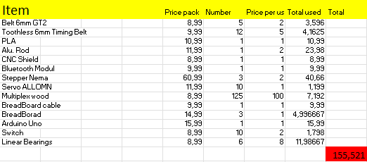

Step 13: Bill of Materials
Here is a list of materials with the price for a pack, the number of item on the pack and the number used. In total used column, it’s the price for the number of item used. In total we have spend 155.21 euros which is under 200 euros constrain.
