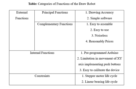

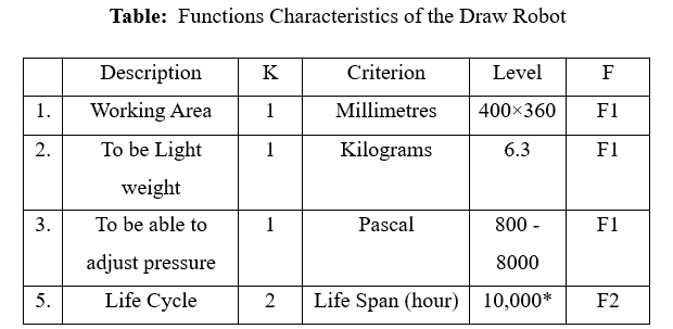

Functions of a Draw Robot can be categorized into external functions and internal functions. The external functions are the ones that are directly useful to the customer and they can be divided into two categories: Principal functions and complementary functions whereas the internal functions depend already on the design choices. The external functions include the principal and complementary functions and the internal functions represent the limitations and considerations that should be considered when making design choices.
These functions have been categorized in a table and are shown in the given pictures.

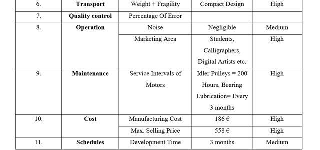

The next step is to make a function chart that exhibits some characteristics of the Draw Robot according to their nature. In the table given below, the co-efficient K refers to the level of importance of a function that is functions with co-efficient K=1 is more important than K=2. The flexibility level is described using the co-efficient F where F1 represents small flexibility, F2 represents moderate flexibility, and F3 represents large flexibility

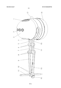

1. Robotic Drawing
Publication Number: WO2020072785A1
Publication Date: 2020-04-09
Website: https://worldwide.espacenet.com/patent/search?q=p...
Conclusion: The manufacturing cost and maintenance of this robot is very expensive.
2. Drawing Robot System
Publication Number: WO2021103417A1
Publication Date: 2021-06-03
Website: https://worldwide.espacenet.com/patent/search/fam...
Conclusion: The working area is limited and it does not meet our objective, applying pressure.

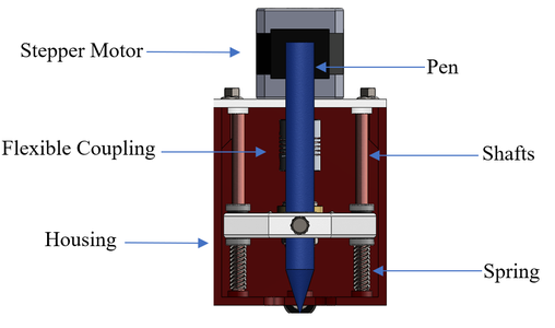

2. Z-Axis housing: As our main aim of our project is to write with varied thickness, this can be achieved with a simple yet important mechanism of converting the rotational to linear motion with the help of flexible coupling and lead screw. The stepper motor is connected with flexible coupling which moves in up and down direction with the help of lead screw, thereby creating variable thickness. This complete setup is enclosed in a special house, named as Z-Axis housing.

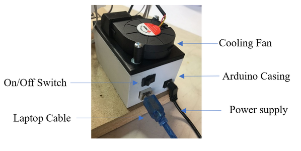

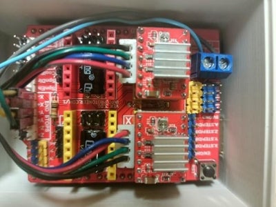

3. Electronic Setup: The electronic and electrical setup is enclosed in a special box to avoid accidents. The Arduino is connected with the CNC shield and drivers to drive the three stepper motors is powered electrically with 12V DC current and is connected to a laptop. In order to avoid overheating, a cooling fan is attached to the box which is shown in figure below. This casing if fixed in the corner of the board so that it does not interrupt the robot.

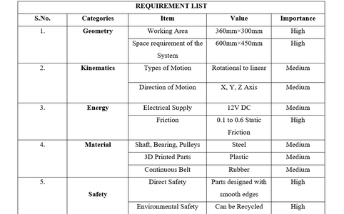

a) Requirements: A requirement list is a nested list which contains adequate quantitative and qualitative information. Determining the requirements of a Draw Robot, helps us to focus on the appropriate design criteria and implement appropriate design decisions. The crucial values of the project will be analyzed by prioritizing and categorizing techniques.

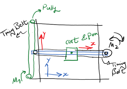

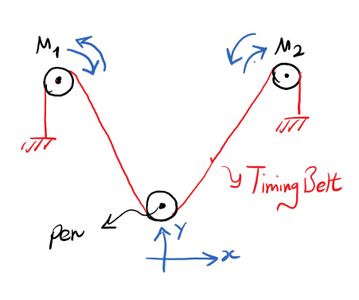

b) Conceptual Design: The next step after the requirement list is to find concepts to reach the design criteria. The conceptual design is the initial level of the design process where different concepts are considered and analyzed. Several parameters should be considered and discussed in order to select the best one and to improve the final design.
The main challenge in our project is to guide the pen to the correct vector lines so that it creates a picture with utmost accuracy and precision. In the table below, the essential problems and respective solutions have been discussed.
As all of our team mates are from engineering background, each of them has proposed their own ideas and thoughts about the different types of concepts which can be adopted for this project. Out of concept 1,2,3, we choose the one which satisfied all the conditions which is discussed in the table above.
c) Embodiment Design: The embodiment design is the step of the design process where the design of the product is developed with consideration of both technical and economic criteria. The three basic rules for this step are clarity, simplicity and safety.

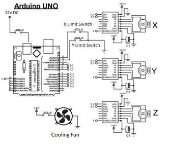

2. Circuitry & Sensors: The electrical schematic of the system containing Arduino, the heart of the system, DMOS Micro steeping Motor Driver, three stepper motors, three capacitors, and two switches are depicted in the figure above.
The direct current (DC) voltage needed for the Arduino is between 9 and 12. However, the microcontroller Atmega8 embedded on the Arduino board needs 5 volts to run. To convert this voltage, an integrated circuit (IC) MC33269 - Voltage Regulator Adjustable Output – is already provided to make the voltage needed for it.
Arduino, which is already programmed, sends two commands to each driver namely direction- and step-pin. The direction-pin, indeed, controls the direction of the stepper motor to turn clockwise (CW) or counterclockwise (CCW), and the step pins control the speed of the motor by providing different time duration.
The Arduino Microcontroller controls the position of the stepper motors using software instructions. A brushless DC electric motor that divides a whole rotation into a number of equal steps is known as a stepper motor. Three stepper motors for the X, Y, and Z axes are used to provide precise control over the drawing pen for object sketching. Stepper motor drivers are used to drive stepper motors that can rotate continuously while maintaining precise position control without the need for a feedback system.

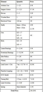

Step 13: Bill of Materials
The cost of the Draw Robot has been categorized into two parts.
a. Manufacturing cost of 3D printed parts &
b. Components cost.
Reference Website: 3D Printing Price Calculator - Prusa Printers

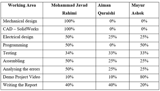

Step 14: Work Distribution and Presenting the Team
a) Mohammadjavad Rahimi Dolatabad – He has received B.Sc. Degree in Electronic Engineering program in 2010, Tehran. He obtained his first master's in Mechatronics Engineering in 2020 at Sharif University of Technology, International Campus, Kish Island, Iran—ranked first among Iranian universities.
Please visit his website for more info http://mj-rahimi.com
b) Aiman Quraishi – He has received Bachelor’s in Technology in Mechanical Engineering from JNTU – Hyderabad in the year 2021.
c) Mayur Ashok Sonawane – He has received Bachelor’s in Technology in Mechanical Engineering from Savitribai Phule Pune University, Pune, Maharashtra, India.
