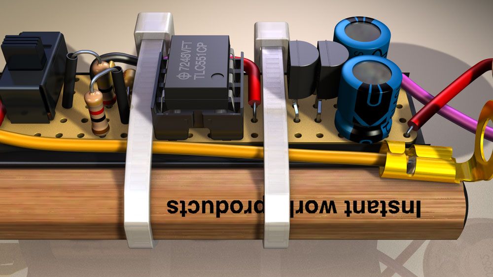

Part 1 shows the preparation of the stripboard, position of the jumpers and the complete build-up of the electronic components in the order of soldering.
