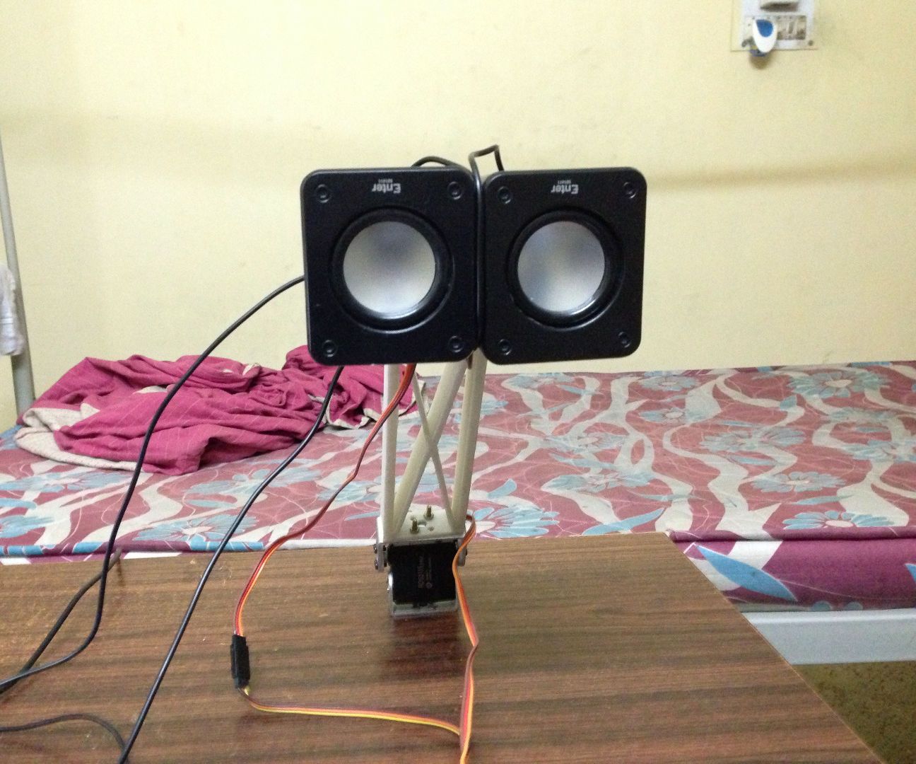

Step 2: Mechanical Design
From the pictures above you get the idea of what the design is and how you should go about assembling it. It is more like playing with maker kits when you were 5 or 6 years old. So lets start step by step construction.
  1. Drill two holes in each of the horns such that the distance between the two holes is same for all the horns as given in the picture.
  2. Now we have to make a rigid support for one end. Drill four holes at appropriate distances as the screws of the servo and attach the servo to the box. We will use this setup to give a rigid support to the setup.
  3. Join two combinations of aluminium stripes from the kit to any two horns as shown in the picture such that the distance between the two horns should be ~20 cm.
  4. Now attach one horn to the servo with rigid support and one to the other servo and before fixing the horns, calibrate the servos to 90 degrees so that rigid servo is parallel to the stripes and the free end servo is perpendicular to it.
  5. Now take two longest stripes (15 cm) fro the kit and attach them to the lower end of the free end servo parallel with it.
  6. Then attach caster wheels at the bottom of the arm with the pen which we constructed in step 5 for proper balance and support.
  7. The last servo should be attached at the end point of the step 5 with feviquick or glue gun anything that makes it rigid there.
  8. With a stripe of appropriate length and clothespin attach the pen to the servo such that the distance from the free end horn and the pen tip should be ~20cm.
While construction two points should be kept in mind that the distances mentioned above should be 20 cm and calibration should be done properly. Rest of the construction depends on the availability of parts and your wish. For example instead of aluminium stripes from the kit you can use rulers for arms etc.
