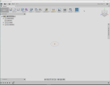

We started by creating a sketch looking down on the X/Y plane and created a circle. Next we created an offset plane and created a new sketch of a smaller circle on that. Using the loft tool, we connected the 2 circles to create a solid body.

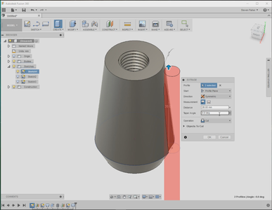

Next we drew on the top face of the body to make the hole to attach the handle to the drill press. Using the extrude tool, we put a negative number (-12) to cut into the body.We then used the thread tool to model the M8 threads we needed, but we only allowed them to go 8.5mm down the hole. This was to address an issue with the original which caused it to fail in the first place.

Step 4: Creating the Grips
To create the grips, we went back to the first sketch and added a circle at the outer edge of the first one. using the extrude tool we cut the shape into the body, making sure this was done in both directions.
Once this was completed we used the circular pattern tool to copy the cut around the handle finishing the model
