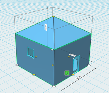

Step 5: Sketch the Door.
Click on "sketch" then "sketch rectangle". Next, select one of the faces of the box and draw a rectangle of width five and height ten.
Step 6: Construct the Door and Windows.
Select the "extrude" function and then select the sketch of the door. The value for extrusion is -1.
The windows are constructed the same as the door. Design them to your preferences.
Step 7: Combine Pyramid and Box.
Zoom inside of the pyramid and use the extrude function to extrude. The value should be -2.
Step 8: Optional: Scale to Desired Dimension.
Select the entire structure and click on "Smart scale" in the bottom bar. The dimensions of the structure should appear. Modify them to the size you desire
NOTE: the default measurement 123D design uses is mm. It accepts other units of you specify correctly in the dialog box.(ex: 40 in)

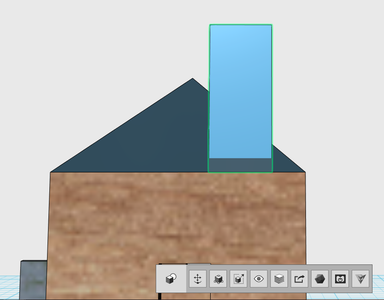

Step 9: Optional: Constructing the Chimney.
Create a box then smart scale the box to the dimensions 15mm by 16mm by 38mm and place it flush with the bottom of the roof in the right back corner of the house.
Step 10: Step 10: Hollow Out the Chimney/roof (optional)
Copy the rectangular prism and scale down the dimensions to 12mm by 12mm by 40mm (gaining height at the top). Make a copy of the 12mm by 12mm by 40mm prism and set it aside. Next use the cut subtract tool (In the combine submenu) to subtract the small prism from the larger prism. Then re position the copied 12mm by 12mm prism inside the hole of the larger prism and use the subtract tool again to subtract the 12mm by 12mm from the roof.
