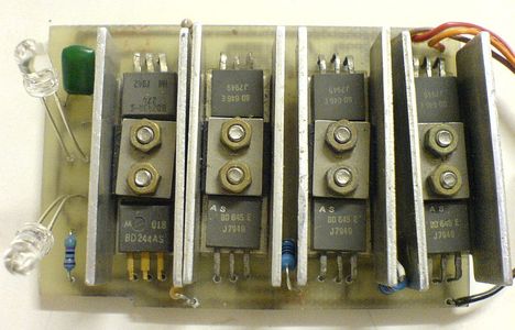

This design uses 16 transistors, 8 per board, for the pan and tilt axes.

The idea of using transistors to drive the motors was sourced at the Redrok energy site. I used the "LED5S5V Simplified LED low power tracker", its a long web page, use Ctrl + F in your browser to find the spot, or direct link here Led5S5V.
The max current using the suggested 2n2222 transistors is about 100ma, a bit on the small side for my intended motors and so I used some BD634's and 245's I harvested from an old telex machine. These are capable of 1A and will easily drive my RC servo's and small hobby motor.
I'm using rechargeable RC ni-cad batteries for the initial testing phase, but I imagine the LM7805 5V TO220 style voltage regulator would be able to drive both the pan and tilt axis from the panel itself.
I used a 5mm Clear Ultra Pure Green, 20° due to the high, 1.7V bandgap voltage. It is this voltage of the 2 leds back to back which is summed and the difference amplified by the 8 transistors which then feeds the motor, so a high as possible voltage is needed.
The bandgap voltage is easy enough to check, connect a meter to the led leads and point the led at the sun, the wide angle greens (120°) were a disappointing 0.45V.
The attached files were created using the free ExpressPCB software, comprising a basic schematic and my final pcb layout.
Some components are missing from my schematic so its best to work off the original at the Redrok site, led5s5v schematic
