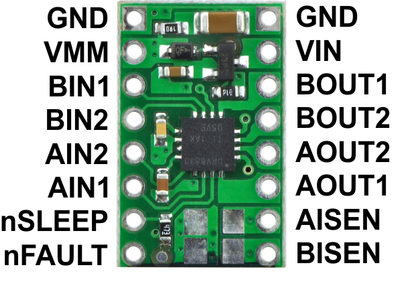

Step 3: DRV8833 Dual Motor Driver Board
In the circuit, I preferred Pololu's DRV8833 dual motor driver board. Although the dimensions of the board are almost as small as an L293D motor driver chip, the features it offers are quite powerful compared to its size.
As a maker, I prefer pluggable boards in my circuits because it provides great convenience and flexibility in realising my projects. XIAO ESP32 C3 pins have a logic signal level of 3.3V. Some popular motor drivers, such as the L293D, require a logic level of 5V. However, the DRV8833 provides motor control at approximately 3V logic level, making it directly compatible with the XIAO ESP32 C3.
Furthermore, the DRV8833's operating voltage range is from 2.7V to 10.8V, making it compatible with a wide range of power supplies. Using this driver will benefit your projects in many ways.
For more technical details: https://www.pololu.com/product/2130
