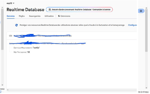

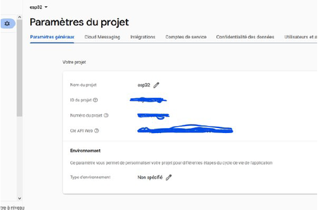

Step 2: Setting Up Firebase
Firebase will be our cloud database. We need to:
1. Create a new project in Firebase Console
2. Set up Realtime Database with a simple structure{"NbrPersonne": 0}
3. Configure security rules to allow read/write access (temporarily for testing, then secure it
later)
4. Enable Firebase anonymous auth to obtain a temporary API key.
5. Note down your Firebase credentials (API key, project ID) for the ESP32 code

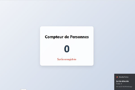

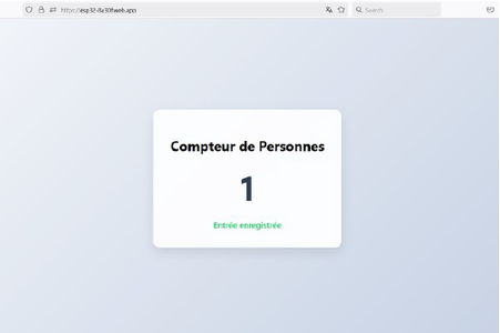

Step 4: Creating the Web Interface
Let's build a simple but effective web dashboard:
1. Basic HTML/CSS page with a large counter display
2. JavaScript to listen for Firebase database changes
3. Visual indicators when counts increase/decrease
4. The page will automatically update whenever someone enters/leaves the room - no refresh needed!
5.Replace these values with your actual Firebase project details
apiKey: "your API",

<div class="counter" id="counter">0</div>
<div class="status" id="status">Connexion en cours...</div>
</div>
<!-- Chargement conditionnel de Firebase -->
<script>
// Détection Electron
const isElectron = window && window.process && window.process.type;
// Configuration Firebase
const firebaseConfig = {
apiKey: "your API",
databaseURL: "your database URL",
projectId: "your Project ID"
// Initialisation
function initFirebase() {
const app = firebase.initializeApp(firebaseConfig);
const database = firebase.database();
const counterElement = document.getElementById('counter');
const statusElement = document.getElementById('status');
let previousCount = 0;
// Écoute des changements en temps réel
database.ref('NbrPersonne').on('value', (snapshot) => {
const currentCount = snapshot.val() || 0;
counterElement.textContent = currentCount;
// Logique de notification
if (currentCount > previousCount) {
showNotification('Entrée détectée', `Total: ${currentCount}`);
statusElement.textContent = 'Entrée enregistrée';
statusElement.style.color = '#2ecc71';
} else if (currentCount < previousCount) {
showNotification('Sortie détectée', `Total: ${currentCount}`);
statusElement.textContent = 'Sortie enregistrée';
statusElement.style.color = '#e74c3c';
previousCount = currentCount;
}, (error) => {
statusElement.textContent = 'Erreur de connexion';
console.error("Firebase error:", error);
