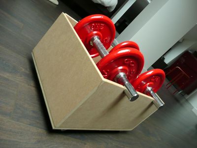

A box to keep your dumbbells, with casters to tidy your room without lifting the dumbbells.
The box is deep enough so you can put your additional dumbbells or other stuff.

You need 5 wood boards. I have used Medium-density fibreboard (MDF), thickness 1cm :
- 40cm x 18 cm
- 40cm x 18 cm
- 32cm x 18cm
- 32cm x 18cm
- 42cm x 32cm
also 4 casters, a long piece of wood and some screws.

use the long piece of wood and the screws to put the pieces together.
Step 4: Slots
cut 2 littles slots on the side to put the dumbbells.

Your dumbbells box is ready !
you can paint it with the color of your choice, MDF is a very good material for painting. I've been lazy on this one so I just let it as it is.
