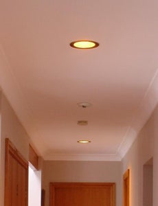

The hall lights and the standard lamp were fitted with blue blocking light globes so that they provided soft light glow without any harsh glare.

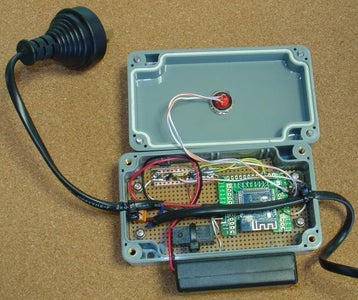

Step 2: Battery Powered BLE Controlled Light Switch for a Standard Lamp

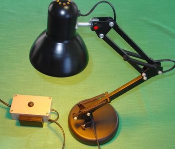

To turn a standard lamp on/off at Dusk/Dawn, either the DFROBOT or the Panasonic latching relay version (shown above) of the Very Simple BLE Power Switch is used with the manual push button override fitted.
It is inserted into the power lead of the standard lamp by cutting one of the leads and connecting the two ends to the relay terminals.

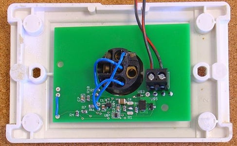

Step 4: The BLE Controlled Mains Light Switch – Retrofit
WARNING: This BLE Controlled Mains Light Switch is for Experienced Constructors Only. The board is Mains Powered and can be deadly if any part of it is touched while it is running. The wiring of this board into the existing light switch circuit should only be done by a qualified Electrician.
To control the Hall lights, the existing light switch was retrofitted with the BLE LED Light Switch. No extra wiring was needed as the BLE LED Light Switch works without a neutral connection.

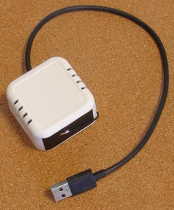

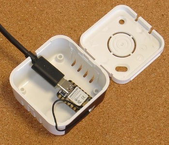

To connect the lux sensor to the BLE Controlled Mains Light Switch, this small ESP32-C3 board with an external antenna was used. The external antenna allows longer range connections.

File slots for the antenna lead and the USB cable and stick antenna on the outside of the enclosure and place ESP32-C3 in the enclosure.
NOTE: Use a vented enclosure as the ESP32-C3 runs hot.
