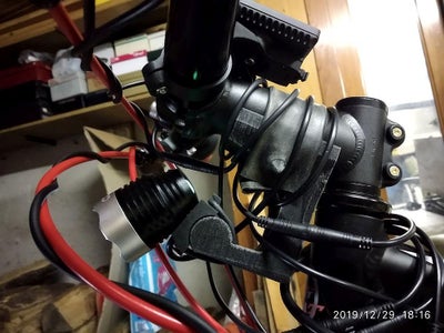

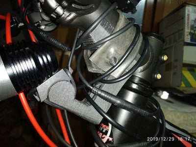

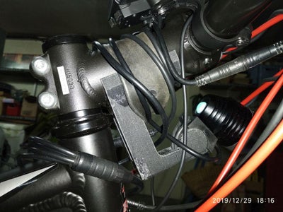

so i decided to make another fixture to remedy to these points.

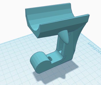

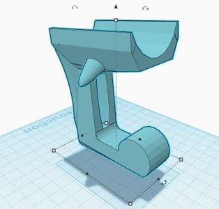

i have a 3dprinter but limited modeling skills so i tried it on tinkercad with basic additions/substraction operations.
my mounting bracket is set under the bike stem, centered, and perfectly held in place just by a piece of inner tube.
the measurements are taken on the bike : diameter and length of available space under the stem and reported in tinkercad. you may have different values on Your bike. the rounded part on the bottom uses the original thick rubber retention ring from the light.
i used it for 8 months with absolutely no issues until my bike was stolen. so i think it is strong enough.
