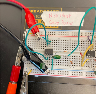

Step 1: Constructing the INA Filter
The first step is constructing the INA filter. This filter is set up to have 3 op-amps connected through a series of resistors. These resistor values were chosen in order to receive an output gain of 2 using an output voltage equation. Once the resistor values had been chosen, the circuit was built as seen in the LTSpice schematic. The picture displayed on the left is the real circuit. Each op-amp was supplied with 15 V on the positive terminal and -15 V on the negative terminal. The positive and negative voltages are supplied through the rows at the top and bottom of the bread board. The positive and negative terminals were then connected to each op-amp through jumper wires.

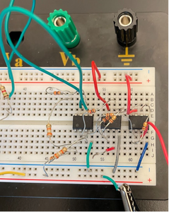

Step 4: Finalizing the Overall Circuit
The final step in building the circuit is to connect the outputs of each op-amp into the inputs of the next filter. For example, the output of the INA will be connected with a jumper wire to the input of the notch filter. The output of the notch filter will then be connected with a jumper wire to the input of the lowpass filter. The oscilloscope will then be attached to the output of lowpass filter and the function generator will be connected to the input of the INA filter. The last step is to ensure that each op-amp is connected to the positive and negative terminals because each op-amp needs a power supply to function properly. When everything is put together, the oscilloscope will display a simulated ECG.

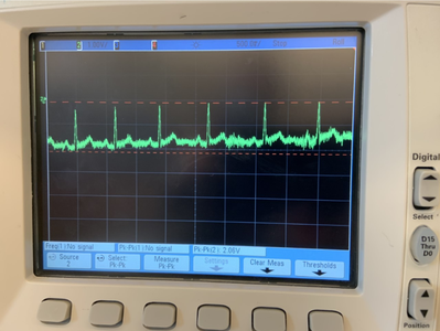

Step 5: Connecting to a Patient
To ensure the project works, a patient was hooked up as the input into the circuit. If the project was built correctly, the oscilloscope should display the patient's ECG signal. As seen above, when the patient was connected, a proper ECG signal was displayed on the oscilloscope proving our project was built correctly. Once finished, a simplified ECG signal amplifier has been built!
