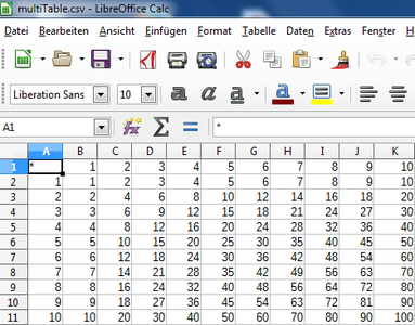

Step 3: CSV Opened With a Spreadsheet Program (Excel, Open Office Calc)
If you open a csv with a spreadsheet program it should be look like above.

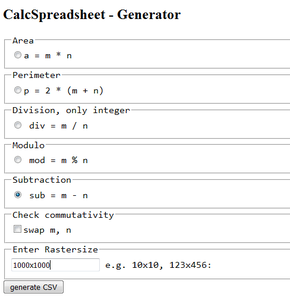

So we begin with the diagram that is showed on the top and start with the html file that contains a form with radio, checkbox and generate buttons
Step 5: HTML - Form
The form is for the human interaction process, containing the visual elements, (radio) buttons, checkbox. It will be accessed by the controller module.

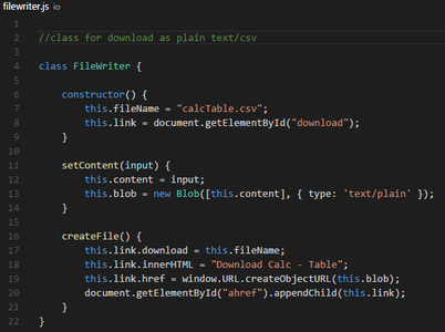

Step 10: CSV/Txt Filegenerator
The Filewriter constructor contains a filename string variable e.g. "calcTable.csv" and the downloadlink is generated via DOM.
setContent() stores the generated String from the calculation module into the Blob(), that can takes up a set of Strings as text or csv. The method createFile() generates a downloadlink of the blob, that represents as csv or text file.
Step 11: Run the App!
So if you open up autoCalcGUI.html with your browser you generate simply a calculation spreadsheet, by choosing operation, entering the rastersize (e.g. 123x456) and clicking the generate button, then suddendly a download link for the csv-table appears below.
