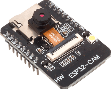

I recently fell in love with the ESP32-cam board. It really is a wonder machine! A camera, WiFi, Bluetooth, sd-card holder, a bright LED (for flash) and Arduino programmable. The price varies between $5 and $10. Check https://randomnerdtutorials.com/projects-esp32-cam/ for projects you can use this camera for. I was drawn to this incredible piece of electronics by the lovely work of Bitluni.

- Desolder the headers from the board. You can choose to keep the six male headers you need to program the board (GND, U0R, U0T, VCC, GND and IO0). I desoldered everything.
- Then solder six female headers (in one piece) to the programming pins GND, U0R, U0T, VCC, GND and IO0. You won't need VCC but for a strong structure it is better to use one straight six holes header.
- Solder two wires to 5V and ground. Make them about 1" long.
- Cut down the female header plug as far as possible and solder the 5V and GND wires to the connections of that plug.
