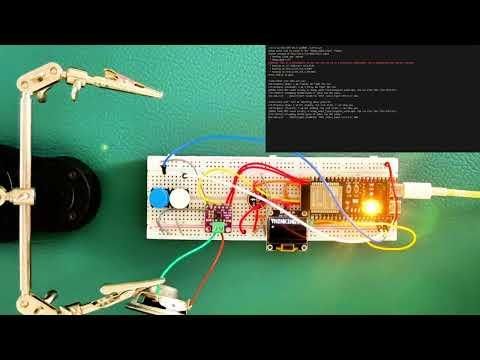

This project combines an ESP32 microcontroller with a Python server (using Google's Gemini AI for smart responses and gTTS for speech) to create a device that talks to you without ever listening. It's a fantastic way to learn about microcontrollers, AI APIs, and text-to-speech, all while keeping your AI token usage super low!
Hardware Components:
  1. Microcontroller: ESP32 Dev Kit C
  2. Display: 0.96" OLED Display (SSD1306, I2C interface)
  3. Audio Output: MAX98357A I2S Class-D Amplifier + Small 8-ohm Speaker
  4. User Input: 2x Tactile Buttons
  5. Visual Cues: 1x Red LED, 1x Green LED
  6. Miscellaneous: Breadboard, Jumper Wires (male-to-male), USB Power Supply (at least 1A)

  1. Power Up: Connect power to your ESP32. It should connect to Wi-Fi, and the OLED will display "Ready" with the green LED solid.
  2. "Next" Button: Press this button to cycle through the predefined phrases on the OLED display.
  3. "Speak" Button: When you've found the phrase you want, press "Speak."
  4. The OLED will show "Thinking..." (red LED solid) as the ESP32 contacts the server.
  5. Once the server responds, it will switch to "Speaking..." (green LED solid, red LED blinks) as the audio plays.
  6. After playback, it returns to "Ready."
The Token-Saving Trick: Remember, the Python server deliberately limits the length of the Gemini response to keep your API token usage (and potential costs!) down. It's an efficient little system!
