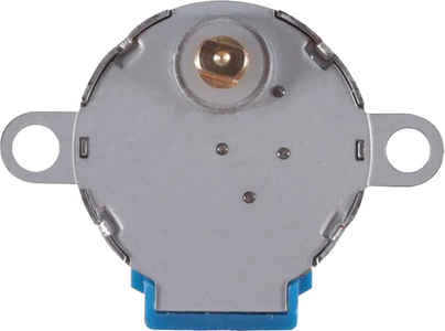

At first I used a Nema 17 motor, only for test purpose because it a little bit bulky. This motor Is strong enough to pull the blinds, but it has one downside. When there is no power on the spools the axis of the motor can spin freely. This means that the blind comes bashing down, after it pulled it up all the way.So I tried using a PM42S-48, this little stepper has quite a punch. But also the same problem as the Nema 17 Motor when there is no power on the spools.
Meanwhile I had figured out how to control the stepper in ESP Open RToS. Then I thought of having a second look at the 28BYJ-48 12V stepper motor. It turned out that it’s quite simple.
Now this kind of motor is not really up-to-date with modern technology. Uni-polar stepper motors are not that common anymore. Bipolar steppers are twice as efficient with the same amount of copper on the internal windings. Even in full stepping mode, a uni-polar stepper still has 2 out of four wires not active all the time. So basically, if there was a way to run current through all windings in the motor at all times, the thing would be stronger and faster. That’s what happens in a bipolar stepper motor. It has only two windings instead of four in a uni-polar stepper. Both windings can be activated all the time, but their polarity is switched in four steps.

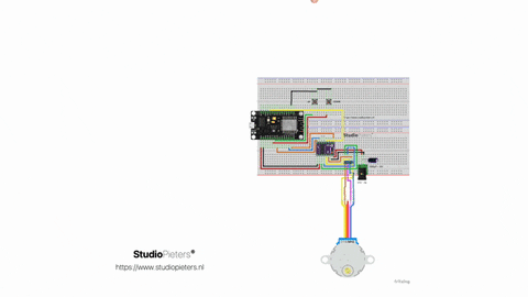

Step 2: Blinds Scheme
As you can see this scheme is a little bit more complex than the average HomeKit setup. I used a Node MCU V3 Lua ESP-12E WiFi Development Board in this setup, in combination with a DRV8825 Stepper driver module.

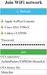

You must configure wifi network and OTA repository. To configure wifi settings, device generates its own Wifi in AP mode. You must connect to it in order to setup your wifi network. Simply take your iOS device, go to Setting -> Wi-Fi, and search a SSID with LCM- followed of last MAC address, connect to it, and wait a few seconds until a web appears showing you all wifi networks that the device has found. Select yours, and enter password. Don’t touch Join button yet!!
Step 6: Software Installation
Now, you must configure OTA repository as well. It’s very important that you configure it right, because you can not change it in the future (If you make a mistake, you must erase and flash device again).
OTA repository:
AchimPieters/ESP8266-HomeKit-Blinds
OTA binary file:
main.bin
To finish initial setup, click Join button and wait about 7 minutes until process finish (While installation is working, device doesn’t show anything, and buttons don’t work). After that, LED turns on for a couple of seconds and you will be able to add your accessory to your HomeKit ecosystem using Home App. LCM will install your HomeKit device on your ESP.
