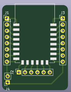

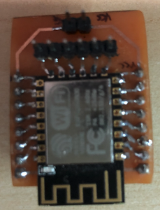

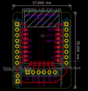

Step 1: The ESP8266 Bare Breakboard
The main purpose of this is to show you how to work with the bare ESP8266 module. As it is not solderless breadboard friendly, we will have to prepare a board that we will plug to the breadboard and that is the only feature of the board. The ability to have a ESP8266 module to be used in solderless breadboard.
You may be asking yourself why not using a frogo board like this. Well, you can and I advise you to do so when you already have your circuit well defined and working. But that board, already has the minimum system and snap you ESP8266 module to it wont make it work if you dont have your minimum system wherever you plan to use it. So, there are some development steps that will need to try and adjust with the bare module before you get a PCB working. That is what this whole tutorial is about.

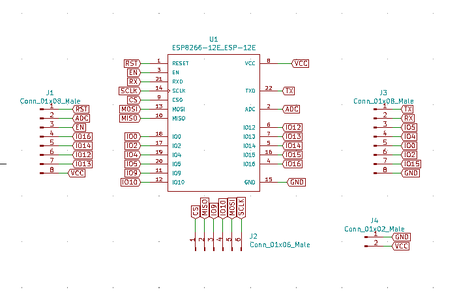

The schematic for the breakbord is just a matter of getting the pins of the module and exposing them in a 2.54mm pitch pin header.
I created the schematic using Kicad but you can use whatever you feel more comfortable with.
This board is very easy to generate at home using etching process with Ferric Chloride. I will not go into the details of that but I have done many PCBs using this method and it is perfect when our circuit can be implemented using a single layer and it is a way to test your schematic as close as possible to what would be your final design.
The kicad project can be found here

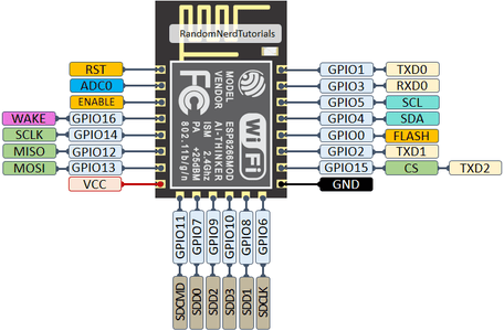

Esp8266 module is a 3.3 Volts module and it is not 5V tolerant. Keep that in mind when you use a breakboard which doesnt feature any voltage regulation otherwise you may burn your module. Although it will work with 3.7 Voltage batteries, those batteries can range from 4.2 Volts to somewhere below 3 Volts and still able to keep the module running. But, the top maximum rate for a ESP8266 is somewhere around 3.96V. I have used those batteries to power my modules and that wont burn the module immediately but it may damage it eventually.
With that in mind, I am assuming you have a power supply capable of supplying a 3.3 V and that is what is going to be used to power the module.
That said, lets go into the requirements for the minimal system. The main source of information for this module is the ESP8266EX Datasheet authored by Espressif. This document is very technical but it is a must scan it to say the least if you want to learn more about ESP8266.

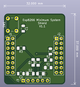

Aside from the power pins which needs to have the Voltage potential for operation, the following pins we need to make sure are in the right state as below:
- CHIP_EN - HIGH (10K pull-up resistor)
- GPIO15 - LOW (10K pull-down resistor)
- RST - HIGH (100nF cap or 10K pull-up resistor)
- GPIO0 - HIGH(100nF cap or 10K pull-up resistor)
The schematic for the minimum system board can be found here

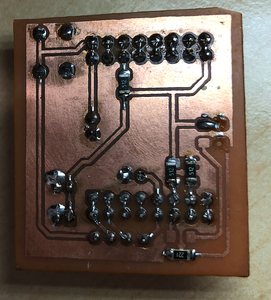

Step 3: The Final Result
Now, we have a shield board which will get a bare breakboard on the back and once power is applied will give the module its normal operation. So, whatever code you have it running there will work as it supposed to.
For my final version I have the pins for programming in the bottom of the shield. Those pins are required for uploading your code using a FTDI and some components.
