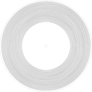

The end result wasn’t as great as I had hoped. There were two major flaws in this first print. One, the eucalyptus wood, it’s not a great material to start with, it shreds and when I was printing I noticed that one side was slightly tilted upward, leaving less distance between the wood and the laser, this side was notably more burnt. Secondly the space between grooves was minimal, this caused that sometimes two grooves would interlap. When the record was played a lot of grooves were chipped by the needle, but the song was recognizable and even after the chipped grooves it still played well.

This second attempt was in the end my best attempt out of the three I did. I had asked for more time on the laser after my experience with last time, I was able to print all the grooves in roughly around 3 hours. I also changed the properties of the laser so it would print as fast as possible with the depth I needed for the needle to pass through.
I noticed that the outer grooves of the record sound much better than the inner grooves, this is due that it takes the same amount of time for an outer groove to complete a cycle than the inner grooves (45rpm), but there is a much larger path for the outer grooves to make a whole cycle which translates in more information, thus better audio quality.

I modified the Processing sketch to make a 12” record into a 13.5”. The inch and a half was the space I had to enlarge the record without touching the base of the arm of the needle. I also changed the space between grooves again up to 17. I used a transparent 2mm acrylic.
float spacing = 10;//space between grooves (in pixels) float diameter = 11.8;//diameter of record in inches float outerRad = 5.75;//radius of outermost groove in inches int numGroovesPerFile = 20;
float spacing = 17;//space between grooves (in pixels) float diameter = 13.5;//diameter of record in inches float outerRad = 6.50;//radius of outermost groove in inches int numGroovesPerFile = 5;
In theory this should be the best audio quality out of the three attempts, unfortunately I encountered some problems while I was printing in the laser. Midway through the record someone accidently tripped and unplugged the laser, the printer couldn’t start off again where it had left off, so I decided to just cut it and have half the song in a better quality. The laser I was using was going to take some time in rebooting and the other laser in the workshop was unoccupied so I decided to cut it there. That’s where the bigger problem occurred, both lasers aren’t exactly the same, the cut file was displaced half a centimeter from the center, when placed in the turntable it doesn’t spin like a perfect circle, more like an egg, making it impossible for the needle to stay in place by its own. I was able to hold the needle in place for some time and it did sound better, I think…but after my failure and no longer being able to get more hours for the laser in my university this semester I decided to at least make a cool album cover for my second complete attempt, and have a complete product.
