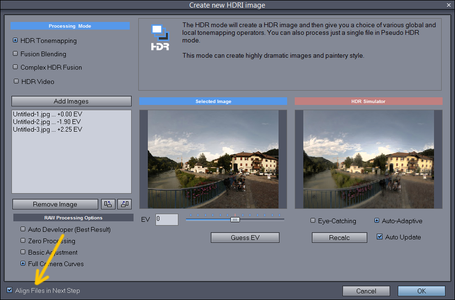

If you've shoot pictures hand-held so you'll certainly need to align them. To do that you can use Photoshop or also an HDR software as DinamicPhotoHDR.
With Photoshop load your three images as layers, go to: Edit > Auto-Align Layers > Auto, and save them with the new orientation.
if you notice that a little irregular frame has appeared, you also have to crop them a bit, use the same crop dimensions for all the pictures.
With DynamicPhoto you can use the auto-aligning feature or manually do it, then check the "export aligned images" box it will save the selected picture, do it for both (you don't need to modify the middle one). Using this program maybe you would put back all the three sets in same folder, because it's faster load them into the program.
