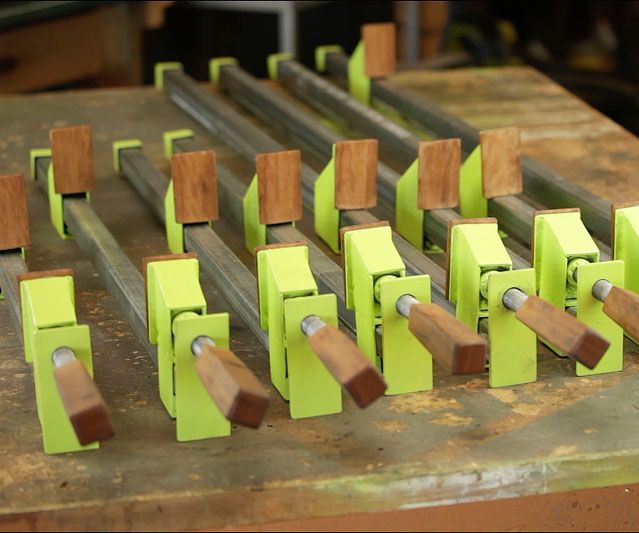

The 'Homemade Bar Clamps' in my first instructable got amazing feedback and I was so blown away by the response that I thought I would make another. I also enjoyed making the instructable too! The one thing mentioned was the amount of work involved and the cost, which are both fair comments. Personally, I like making tools so I'm willing to use my time for that and the cost of materials wasn't that much when you end up with a quality tool (minus labor costs of course). So I've made an easier and cheaper version of the clamps and they turned out great. No welding required. I tried to do most of the work with basic tools, hacksaw, file etc rather than a grinder ( I enjoy this anyway - less noise). I did use my drillpress, tablesaw and bandsaw but those tasks could have been done with a hand drill and handsaw, jigsaw etc. I would think most people who need bar clamps would have at least some woodworking power tools though.
These clamps, while not being quite as heavy duty as the steel clamps, still have plenty of clamping pressure for any glue up and they will still last for years.
There are three main parts of the clamp (four if you count the bar), there's the 'Foot' which slides along the bar and houses the locking nut to grip the bar - the 'Fixed Head' and the 'Moveable Head'. Thats what I will be naming these parts in this instructable.

Step 13: Finished Clamp
The finished clamp turned out great. Much easier/quicker to build and cheaper than my original steel clamps.
The M12 clamp screw is where I saved most on cost - the steel clamps used M16 threaded rod for the clamp screw which bumped the price up a little (M12 threaded rod is much cheaper than M16). These clamps could easily be adapted to use an M16 clamp screw though, which I believe would add to the life of the clamp with its courser thread. But the M12 clamp screw will still last well as long as its not abused by putting more pressure on than needed - the threads could eventually strip out with careless operation.
A glue up shouldn’t need a crazy amount of pressure.
The steel clamps are certainly a little more heavy duty but these clamps use the same bar and are still a very strong and capable clamp with the same ease of use. They will last many years.
