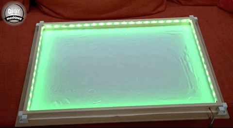

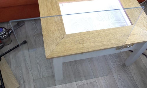

Introduction: Easily Build a MACHINE THAT DESTROYS WHAT IT CREATES - Kinetic Sand Art Table
I’m going to show you exactly how you can easily make your own super cool automated kinetic sand art table step-by-step. Including smart LED lighting.

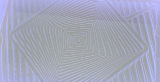

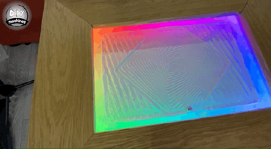

It is incredibly captivating to be beside this simple DIY wooden table as the steel ball magically carves out an endless and ever changing series of beautiful geometric patterns in the sand.
I was inspired to create this after coming across the idea by Sisyphus Industries: https://sisyphus-industries.com
My design is made from low cost pine, which is then painted in chalk paint. The top surface I also veneered with some European Oak. The mechanism that drives the steel ball around is a simple CoreXY design (https://corexy.com) and is controlled by an Arduino Uno and GRBL. An Arduino Nano is responsible for the smart LED lighting, and a Raspberry Pi takes command of playing our looping and ever changing list of patterns.
I also added some physical controls to the front so to allow easy and immediate access to features such as pausing and resuming the drawing, adjusting the LED brightness, speed and pattern.
I created two project videos which show you how to build one (see the next step), but have also written this Instructable out as in certain areas it goes into more detail than the video and some tasks are just easier to follow in writing.
It's probably been the longest Instructable I've written out to date - there are 60+ steps and almost 400 images, but I have tried hard to ensure not to miss a single detail so you have every bit of information you need to successfully build one of your own.

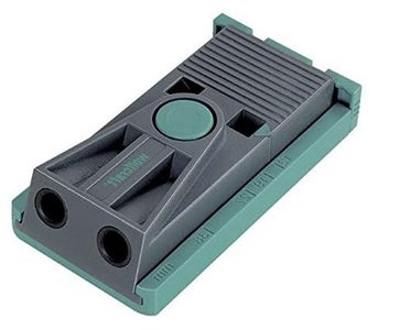

Step 6: Adding Pocket Holes
I decided to learn how to use pocket holes to assemble the frame of my table. They have several advantages, some of which are increased strength, rigidity, and being hidden from view. There is an excellent guide on pocket holes available in this video.
It's a little lengthy but I learned everything I needed to know from it so I wanted to share it with you. I used a simple pocket hole jig: https://geni.us/PocketHoleJig
After following the included manufacturers instructions on setting the correct position of the depth stop on the drill bit (the chunky disc screwed to the drill bit) based on the thickness of the wood, it is as simple as clamping it in place and drilling two holes in each end of the side four side pieces. Their spacing does not need to be precise, just not too near the edges and far enough apart from each other to have an extended grip on the adjoining piece of wood later.
Don't forget to have a look at both sides of the wood panels and choose which side would be better facing outwards. We want to drill our pocket holes into the rougher of the two sides as this will be the side hidden from view.

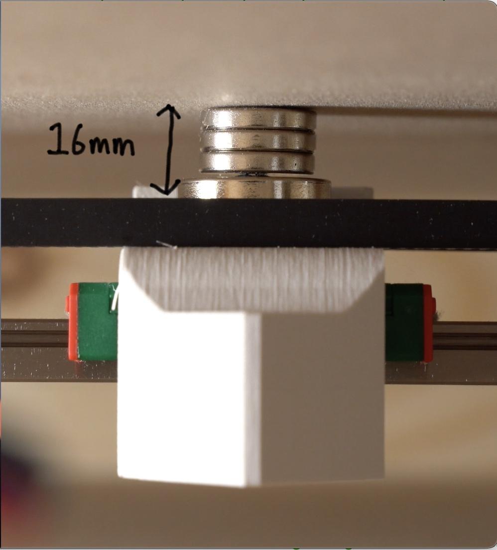

Step 15: Attaching the Magnet Mount
For this step you will need:
- 3D prints:
- MagnetMount.stl (x1)
- M3x8 bolts (x4)
- Screwdriver
Next print the Magnet Mount.
This can then be attached to sliding block on the longest linear rail (on our X carriage - the one which runs side to side) using four M3 x 8 bolts. We will be attaching our magnets and timing belt to this later.

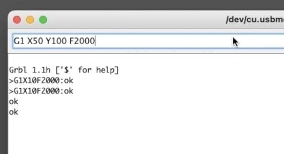

Step 26: Uploading GRBL
We can now upload our pre-customised GRBL software to the Arduino Uno so that we can test our mechanism to ensure that everything we have done so far works as intended. To do this, simply connect your PC to the Arduino UNO using a USB cable and download the code for the project - the code can be downloaded from Github: https://github.com/DIY-Machines/Kinetic-Sand-Art-...
The code is hosted on Github where you can select ‘Code’ and then ‘Download ZIP’. Unzip this folder and save it somewhere on your computer. Now open the Arduino IDE and then in the Sketch drop down select ‘Include Library’ and then ‘Add a zip library’. Find the file you downloaded from Github which should contain a folder called ‘Arduino’ open this and select the GRBL folder and add it.
We can then navigate to 'File' --> 'Examples' --> 'GRBL', and select 'GrblUpload'. Select the board type - Arduino Uno and correct serial port for your board then press upload.
Once the upload is complete you can open the Serial Monitor and set the baud rate to 115200, sending two dollar signs - $$ - should return GRBLs current settings.
To set a command which we want to run at power up, enter the following into the serial monitor:
$N0=G1X10F2000.
To check the start up code we have added send $N which should echo back the parameter we just sent along with a blank value for N1

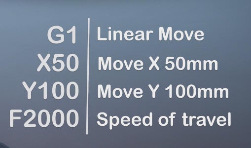

Step 28: Sending Some GCODE
Let’s move the magnet raft using GRBL which is a great way to test everything is working OK so far. To do this we can send a command such as:
G1 X50 Y100 F2000
Your machine should move sideways about 50mm and upwards about 100mm.
If you're interested - the value for G sets the type of movement - 1 means a linear move in a straight line. The values for X and Y are where in the co-ordinate space we want the machine to move to in MM and the value of F is the feed rate or speed of travel.

Step 30: Adding the Magnets
- At least one countersunk magnet (x1)
- M3x12 bolt (x1)
- Additional magnets
- Screwdriver
Once the board fits nicely, remove it and then attach your countersunk magnet using a M3x12 bolt to the 3D printed magnet mount. You can then add your additional magnets on top of this.
You have roughly 16mm of space to fit your magnets between the top of the raft and the bottom of the baseboard. The magnets should be as close to the board as possible without touching it so as to keep noise to a minimum, while trying to maximise the magnetic pull on the steel ball.

Step 34: Framing the LEDs
- Wooden strips
- Drill an drill bits
- Screw driver
- Short wood screws (x4)
We need to assemble a simple frame to hold our LEDs in position. For this, you will need to cut two lengths of 68cm long wooden strips, and two lengths 45cm long. They need to be narrow enough so as to not to sit proud of the side of the table once installed on top of the faux leather.
They can then be assembled with the two shorter lengths inside of the two longer lengths and held together with either screws or glue (or both). If you are using a screw I encourage you to first drill a pilot hole so as to reduce the chances of our wood splitting as we are drilling so near the ends.
After this, make a small hole just larger than the width of the LEDs about 2cm inwards from the end of one of the long lengths. We will pass the wiring for the LEDs through this later.
Step 35: Securing the LED Frame
- 3D printed parts:
- LEDCorners.stl (x4)
- Short wood screws (x8)
- Screwdriver
We can then use four of our 3D printable LED Corners to hold it in place in the centre of our table. When fitting the corner pieces ensure that the fabric our sand is sat on is pulled taut. Any bumps left in the fabric are likely to cause our ball to detach itself from the magnets influence whilst drawing.
Use some short wood screws to fixe the four corners into place - the don't need to be super snug against the frame.
As our corner pieces also double up as handles to lift the top out, we can now remove the temporary screw we used in the first video.
Step 36: Fitting the LEDs
To prepare the LED’s, starting from the end with a connector and the directional arrows pointing away, roughly run a length around the inside of the wooden frame and then cut a little oversized ensuring you cut though the centre off the pads as indicated. We can refine the length shortly.
Thread them through the hole (following the directions of the arrows printed on the LED strip) and then install them by removing the self adhesive backing as you go, pushing them firmly against the wood. Mine adhered fine, but you might need to use glue if you run into difficulty getting them to stick.
When you get all the way around you can trim off any surplus LED's before sticking down the end of the strip.

Step 47: Testing the LEDs
We should now be able to re-connect our LEDs and plug in the tables 12v power supply.
If all has gone as planned our LED’s should light up and you will have control of them using the control panel.
Pressing the pattern button should cycle through different lighting sequences, the brightness dial should adjust the brightness and the speed dial will effect the tempo of the patterns which are animated.
(Some of the patterns such as the 10th, a white one, are static so are not affected by the speed control.)

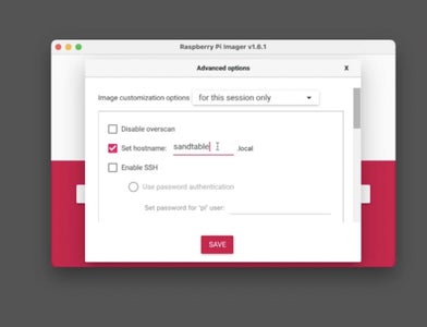

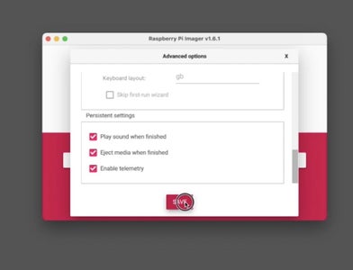

Step 48: Installing OctoPrint
- Micro SD card (8gb or greater x1)
- Raspberry Pi (x1)

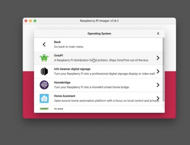

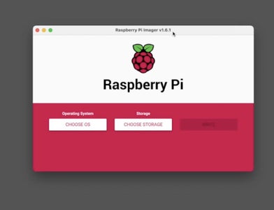

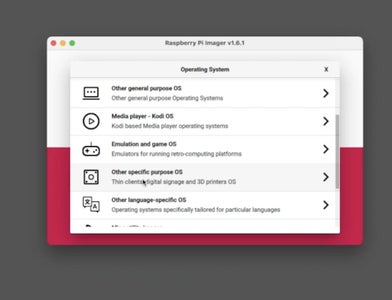

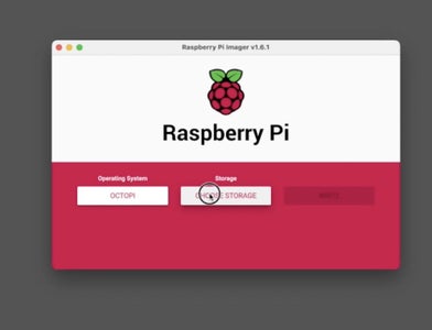

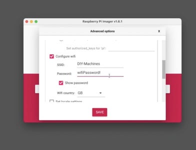

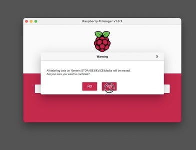

Let's add our Raspberry Pi next. The Pi will be responsible for feeding the GCODE instructions for drawing out our patterns to the Arduino line by line. To do this we will install OctoPrint onto our SD card. OctoPrint is primarily designed to control 3D printers - in fact I use it to control mine with great success. To make it more suitable for our sand table we will add some plugins and change a few settings.
I’ll explain how to do this now, but I also strongly encourage you to check the article for this project on my site - diymachines.co.uk for any revisions or improvements which may have been made since writing out this Instructable.

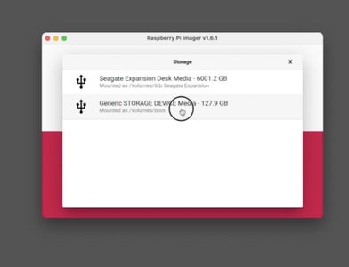

To flash the Raspberry Pi’s SD card we can use the Pi Foundations Raspberry Pi Imager. Head over to the Raspberry Pi foundation website ( https://www.raspberrypi.org/software/ ) and download the free imager from their software section.
Connect your micro SD card to your computer and then open the Raspberry Pi Imager. Press ‘Choose OS’ then ‘Other specific purpose OS’. In this list you should find ‘OctoPi’.
Continue on to select your SD card. Press the key combination of ‘Ctrl-Shift-X’ to access advanced menu.
Check ‘set hostname’ and set one. I chose mine as sandtable (we will use this as URL to access the tables web interface later instead if an IP address). Then scroll down to configure your wi-fi credentials.
We can then press 'Save', then ’Write’. It may take a little time to download the image, flash it to your card and then verify it. It’s a great opportunity to make a lovely cup of tea.
When that is complete we can remove the SD card and insert it into our Raspberry Pi.

To test the play and pause buttons for the GRBL electronics we will first start our machine drawing, and for this we will need an illustration which has already been converted to GCODE. I have included a couple in the files you downloaded from Github earlier, so let’s upload one to OctoPrint now.
Open OctoPrint and then in the left hand column press upload. Navigate to the drawing file called SpriallingSquares.gcode and upload it. Before we can have the machine carve out the pattern we need to connect to GRBL and home the mechanism. Press ‘Connect’ on the left, if this does not connect first time, you may need to try again. Once connected, choose ‘Home’ in the GRBL control window.
Once the homing sequence is complete, and your sand surface and ball are fitted. We can press ‘Print’ next to our GCODE file to have our machine draw out the pattern. Whilst the machine is drawing we should be able to press ‘Pause’ and see the machine gently come to a halt, and then pressing ‘Start’ should cause it to resume.

Step 61: Adding Some Glass
I then ordered some glass cut to size from a local supplier which simply sits on top allowing us to clearly see the art underneath whilst it can be safely used as a coffee table. As this glass is heavy it stays in place just fine.
That’s the table completed, all that’s left to do now is to show you how to easily create your own patterns and how to queue up a playlist.
