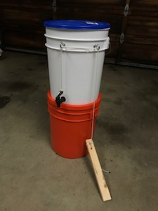

Step 1: Overview
Here's how it works. Based on a design from EVCNB, the Emergency Volunteer Corps of Nehalem Bay, on the Oregon Coast. It's a great community resilience organization. I've learned a lot from them. You can, too.
I modified the EVCNB design by replacing their eye bolts to carry the cord, with drapery hooks that are easier to install and cheaper. The drapery hooks also don't protrude into the bucket, so this design can be stacked, and the stacks placed around neighborhoods, for rapid deployment when needed in disasters.

Step 5: Drive in the Drapery Hooks to Carry the Cord That Operates the Spigot
Mark the two points where you want to attach the drapery hooks, in one of the circumferential bucket ribs.
One point should be straight above the spigot, midway between the bucket handles.
The other should be to the right OR left, one-third to one-half of the way to the bucket handle.
Mark the two points. You can either drill these two holes, or pound a nail through them. Then slide the drapery hooks into place.
With a wire cutter, clip off the pointy ends of the two drapery hooks. The reason to do that is that they can cause minor scratches to people handling the buckets. It's easier to clip off the pointy ends before you install the hooks, but then the blunt ends are a little harder to pop into the holes. Either order works.
Step 6: Run the String From the Spigot Through the Hooks
Tie a smooth light cord through the hole in the spigot. Smooth light cord slides better across the drapery hooks than thicker cord, like paracord. You'll need about 3.5 feet, or 1 meter.
Pass it over the drapery hook straight above the spigot, then over the drapery hook to the side.
The last step will be joining this cord from the spigot, to the cord from the foot pedal, so the foot-pedal tension can be adjusted for the height of the handwashing station placement.
Step 7: Drill & String the Foot Pedal, Tie It in to the Spigot String
Mark two spots near the end of a scrap of wood, about 12 inches long, 3 to 6 inches wide. Pound a nail into both spots, just deep enough to make a divot to stabilize the drill. Drill.
Use a fairly large drill bit, like 1/4 inch, because you can use heavier cord on the foot pedal than the spigot.
Tie any size cord, whatever you have around, through the two holes, and make a knot. You'll need about 4 feet, or 1.25 meters.
Another idea for the foot pedal: A piece of PVC pipe. From Lamorinda CERT, California. No, I don't know how they drill it.
In the Learn-From-My-Mistakes Department: Don't make a foot pedal out of heavy material, like, say, a piece of plastic decking board -- which is, surprisingly, much denser than wood. If the foot pedal is too heavy, the spigot's internal elastic won't be able to pull the weight back up, and close itself. With a too-heavy foot-pedal, the spigot will stick in the open position and waste water.
