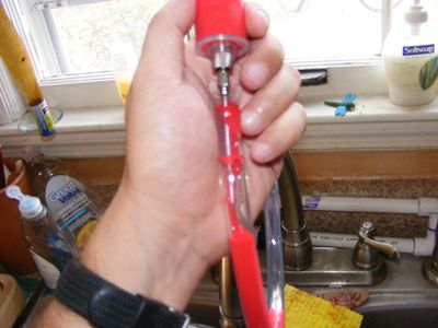

Step 2: Start the Effect Tube
Cut off about three inches of the vinyl tubing and set it aside. Take the remaining long piece of vinyl tubing and squirt just a little dab of vinyl cement into the end of the tube, making sure to get cement all around the top 1/2" of the tube without any gaps. Don't worry if it drips a little further into the tubing. Place the cemented end of the tube into the jaws of a vise, a set of locking pliers or a C-clamp, and clamp tightly. Leave to cure for about 8 hours.
While you're waiting for the glue to dry, do the next few steps.

Once the vinyl glue has cured, remove the effect tube from the clamping device. The end of the tube should be flat and fused closed.
Using a hobby knife, carefully cut a small hole about 3/4" down from the fused section. The hole should be about 1/8" in diameter, and irregularly shaped in order to produce a spray of blood rather than a squirt. Unless you want a squirt, that is. In that case make the hole as perfectly round as you can. Maybe use a drill bit....
If, after testing your squib, you find that it sprays too far or too fine a mist, simply enlarge the hole with scissors or a hobby knife until you get the effect you want.
Once your hole is cut, push the other end of the tubing into the open end of the push-fit splice, and you're done with assembly.
Step 6: Load the Squib
First, power up the squib by inserting a CO2 cartridge* into the inflator. My inflator has a handle that unscrews from the valve assembly, so you just drop the CO2 into the handle and screw it back on. Your inflator may work differently. If your inflator has a safety, engage it before loading the CO2.
Then, remove the open end of the effect tube from the push-fit connector. Cut a slice of banana about 1/2" thick and shove the end of the tube into it, creating a banana plug. Push the effect tube back into the splice connector. The banana plug is to help keep the blood from getting into the valve and gumming up the works. It will get pulverized and blow out the hole when the effect is triggered.
Fill your marinating needle or large syringe with stage blood (if you need to make your own, I'm rather fond of this formula). Insert the needle into the small hole in the closed end of the tube, and fill the tube with blood. Wipe any excess blood off of the outside of the tube, and seal the hole with a small piece of Blu-Tac or masking tape. Use only enough to barely cover the hole to prevent leaking.
(TIP: If you need to camoflage the effect so that it is less noticeable under your actor's costume, use a white version of Blu-Tac, such as Handi-Tac. Then color the putty with a Sharpie to match the color of the costume.)
