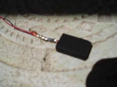

First we remove the wire spring using a pair of pliers (or wirecutters). This will expose the copper lead with the end piece attached. I left removing the end piece until last, it is also possible to just push the spring down, cut off the head and remove the spring.
Strip one end of your copper wire to a length roughly matches the lead on the brush and twist the two wires together making sure to establish a good connection.
I soldered the connection to reinforce it.
Cover the exposed copper with hot glue or epoxy to seal it to avoid secondary reactions.
Voila at this point you have a production grade carbon electrode. In the next step we will test it using a simple aluminum air battery.
