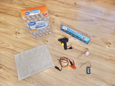

- Aluminum Foil
- Scissors
- Cereal Box
- Cloth (or paper)
- Hot Glue Gun
- Alligator Clips: https://amzn.to/3rKLzkN
- Battery + Connecter
- Buzzer: https://amzn.to/3qahfzs
- Sheet of Card Stock
- Electrical Tape
- Toilet Paper Roll

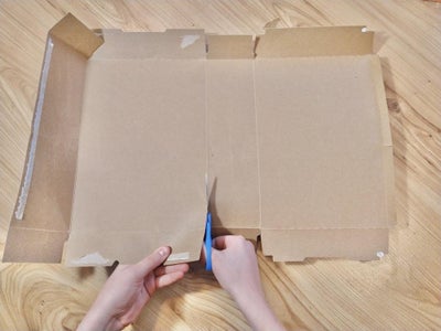

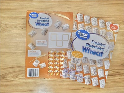

Step 1: Cut the Box
First, cut off the front and back of your cereal box. Throw the rest away and get the hot glue gun heating.

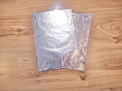

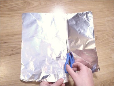

Step 2: Cut the Foil and Fabric
Use the cereal box pieces to trace and cut the fabric and foil to the same size. Make sure that your fabric is larger than the foil. Set the cloth aside.

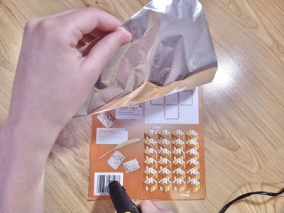

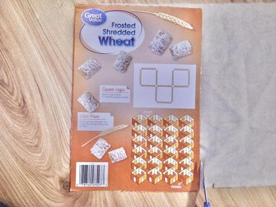

Step 3: Glue the Foil
Use the hot glue gun to tack two corners of the foil to the cereal box, then put three more dots in the middle and other two corners of the cardboard and apply pressure. Repeat this step on the other board.

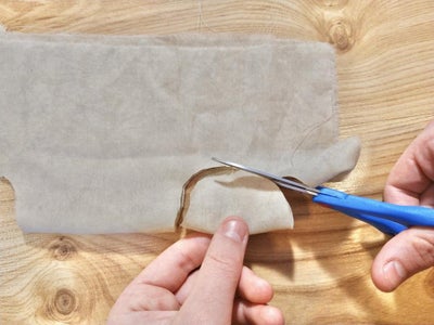

Step 4: Cut and Glue the Cloth
Fold the cloth in half long ways and cut three 1.5-2" diameter holes. Glue the cloth on to one foil board the same way you did with the foil on the cardboard. Glue around the edges of all your holes.

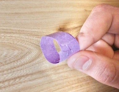

Step 5: Add Paper Springs
Cut a few (5-7) 5" strips of cardstock and glue them in loops. Glue a loop in each hole and a few loops to the fabric. These will work as the springs that keep the plates apart unless stepped on. Let the glue cool before proceeding to the next step.
