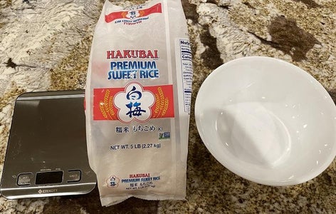

Glutinous rice 500g
https://www.sayweee.com/en/product/Hakubai-Premium-Sweet-Rice/13091

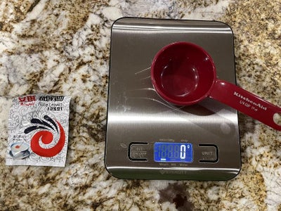

Angel Rice Leaven
https://www.sayweee.com/en/product/Angel-Rice-Leaven-10pcs/18528?category=dried09
Glass bowls
Plastic food wrap
Steamer and cotton steamer clothes
Measuring cup/spoon
Kitchen scale

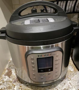

Optional: Pressure cooker/rice cooker (any pot that can make yogurt, like an Instant Pot). Otherwise, you would need a temperature-controlled environment around 110°F.

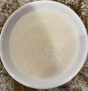

Step 1: Prep Glutinous Rice
Wash the rice until you can pour water in and the water will stay clear. Submerge the rice in water for 12 hours.
It's ready when you're able to easily crush a piece of rice with your finger.

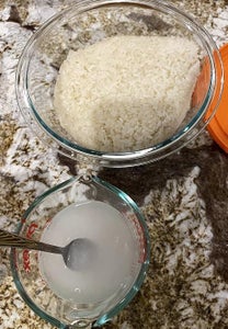

Boil a cup of water and let it cool to around 35°C/95°F.
Add Angel Rice Leaven to the water and mix.
Every 8-gram bag of Angel Rice Leaven (ARL) can be used on 2000-2500 grams rice. So, we measure about 2g of ARL for our 500g of rice.
Pour the mixture into the rice and stir evenly and thoroughly. Leave some mixture for the next step.

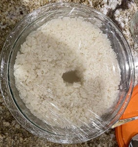

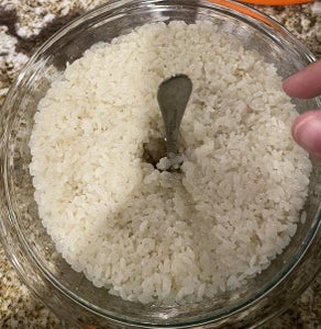

Step 4: Make a Hole for Observation
Poke a hole in the center of the bowl with spoon as shown. Add the remaining mixture from the last step into the hole in the center of the bowl.
This will allow you to:
  • Check the progress of your rice wine by seeing how much the hole is filled up, and
  • Taste test the rice wine

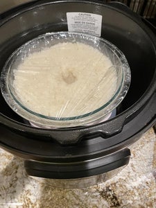

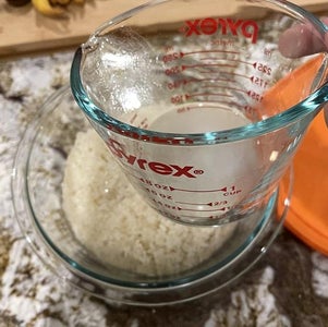

Cover the glass bowl with plastic wrap. Place another bowl beneath the glass bowl (see image 3) so that the rice bowl will be heated evenly.
Choose the option “Yogurt”. Each cooking period is 8hrs on my cooker, so remember to press the “Yogurt” button again every 8 hrs. After 24 hrs., you can open and start to check/smell/taste the center of the hole. It should be starting to smell and taste like wine. After 2~3 days, the rice wine should be ready.
