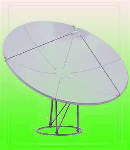

1. An old C-Band sattelite dish. These are still floating around in peoples yards and junk piles.If you ask some people will probably let you have it for removing it. You will need the pole,mount and actuator to go with it. If the actuator is bad you can get new ones from ebay for $30-$50. The dish needs to be the solid panel type not mesh, but it can be the spun aluminum (1 piece) or multiple pieces that bolts together. I think some of the 1 piece are plastic or fiberglass this would work too all you really after is the shape. One thing to remember is that size=power and size changes as the square of power so a 5 foot dish will only have 1/4 the power of a 10 foot

This step is you'll be attaching the mylar film to the dish. Its about as easy as it sounds. One thing to remember is that even though the film may have came on a 4 foot wide roll dont plan on covering a 10 foot dish in 2.5 passes it won't work. Cut it into manageable strips to avoid massive wrinckles. So attaching the film to the dish is as simple spraying glue onto the dish and laying the film on. A few noteworthy hints in this step: make sure you have the dish clean i even went as far as lightly sanding it before i started; after you spray the glue wait about 15 seconds before you start to apply the film so that it becomes tacky and sticks instead of sliding around initially. It should be noted at this point that before taking the dish outside after it has been mirrored to remove the LNB radio reciever from the dish to avoid it melting it or catching on fire and possibly causing damage to the dish, people or property. Also remember that there is alot of power focused into a small point in space. Great care should be given to avoid putting things you dont want destroyed including people or pets. The results will be much more serious than a mild sunburn as this video demonstrates.

As is the theme of this instructable this step is also pretty straight forward. Your going to take copper tubing and make it into a shape to recieve the focused light and put the heat into the water. To determine the size we need to build the collector we need to determine the size of the focal point of the dish. To do this i removed the LNB reciever from the dish leaving the supporting arm in place. This is pretty easily done and shouldnt really need any explanation. Now with the mirrored dish focused at the sun I nailed a piece of scap wood to the end of another peice of wood sufficiently long to keep body parts out of the danger are. At this point hold the piece of wood where the LNB was mounted. Hold it there for about 10 -15 seconds letting catch fire slightly. Now remove the wood from the focus point and lay it on the ground to cool for a few minutes. Measure the size of the blackened wood that you just burned to determine the size of the focus point and therefore the collector. In my case it measured roughly 6 inches across which with my 10 foot dish equates to roughly a 400 X concentration/magnification. Not to make the collector you will need your copper utility tubing. You can get this at the big box store for a few bucks. I used 1/4 inch to allow for sharper bends and close contact with the hot copper. The size of your focus point determines how long of a piece of tubing you need. It usually can be had in lengths of 10 ,20, or 50 feet. I opted for the 20 foot section which was more then enough. In order to allow the tubing to make tight bends you will need to use a little trick I picked up watching them make trombones on "How It's Made". Fill the tubing with water and put it in the freezer for a few hours. If you get a fitting that adapts from 1/4 compression to garden hose this task is really easy. Just remember to have the open ends of the tubing up when you put it in the freezer to keep the water from running out. The ice inside the puting will create a pressure from the inside to reduce the chances of kinking the tubing. It's still possible to kink it but makes it possible to create much tighter radius turns before it does kink. As soon as you pull the tubing out of the freezer start to wrap it around something to give you a nice smooth contour. After the first revolution on your form continue to going around building one wrap ontop of the last untill you reach a diameter slightly larger than the focus point. At this point you have the choice of cutting any excess tubing off or making another rap behind the first in the same manner as the first. after you have done this i decided to solder a peice of copper to supply a little bit of structure. I used a piece of 10 Ga copper wire and a propane torch to accomplish this. One thing to remember here is let the ice melt and drain the water before soldering to avoid being burned by hot water or steam.

Hi, i am about to build the same system and i was wondering why cant we use a mesh satellite dish? I mean once covered with a reflective tape why does is bother if the dish is mesh of alluminium or ...? Thank you and congratulation for your project! :)
