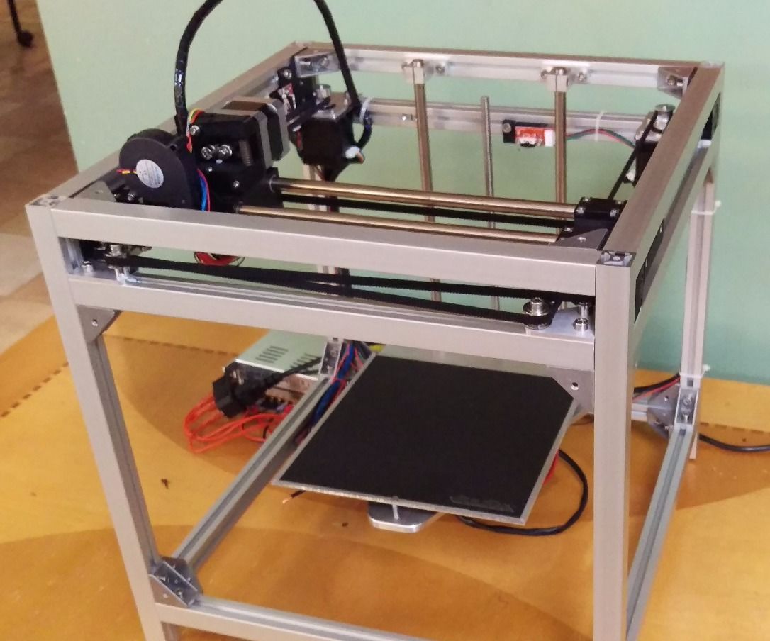

Introduction: Eclips3D - High Precision 3D Printer
This is it! The fully open-sourced printer to trump all others, and at a fraction of the cost. Let's not waste any time! For files, info, and parts to purchase, visit my website here!
If you have any questions about the assembly or post assembly, try checking the forums for the answer:

Step 1: Before Getting Started
The Eclips3D is certainly not made to be a beginners 3D printer. It is designed for people who are familiar with 3D printing and have used 3D printers before. It also may require a bit of work after it is assembled to dial everything in, since the printer is a kit and each person's assembly may be a little different. However, if you put the time in and follow the directions exactly, you will end up with an amazing 3D printer which rivals the speed, quality, quietness, and aesthetics of the Ultimaker 2 or similar. Ok fine, it doesn't look quite as good, but it's not bad for a DIY 3D printer!
After completing the build, head over to the quickstart guide here to get up and running as easily as possible!
Important note: In these assembly pictures you may see red 3D printed pieces instead of cnc'd aluminum plates. This was due to a lack of the plates at the time I made the assembly instructions. In the final printer, you MUST use aluminum plates. If you do not, the quality of your prints will suffer.

Step 5: Assembling the Frame
The frame is one of the more difficult parts, but only because the assembly isn't quite as easy as the rest because of the open slot extrusions! However, using the spacer tool from the printed set (and acrylic panels if you have them) will make the assembly and alignment a whole lot easier!
To assemble, watch the following 3 videos in order!

Step 34: YAY!
Well, at this point you should have a fully built up Eclips3D printer! Which is awesome! But now what? Well, head on over to the Eclips3D Quick Start Guide in order to get everything moving and printing! If you have any questions about the build, please feel free to leave a comment below, contact me on the website, make a post on the Eclips3D forums, or email me directly at 3dprintedlife@gmail.com! Thanks!
https://www.instructables.com/id/Eclips3D-Quick-Start-Guide/
