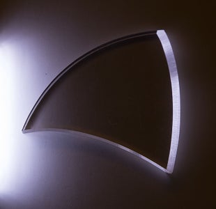

Step 2: Beveling the Edges
The first effect I tried was sanding down the edge at an angle using a belt sander. That way, I still get the most of the brightness of the edge light, but from a front view. You can see that it came out really bright, even in a room that isn't completely dark. A steeper angle comes out brighter but it means there's less surface area visible when looking front on. The other thing is there's less of a "surprise" element since the sanded edges are translucent. I tried burned the beveled edges to get a shiny finish, but it wound up being much dimmer since it decreased the light refracted to the face.

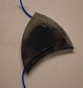

Step 4: One-way Mirror
For this effect, I used a one-way mirror film applied to the acrylic so there would be a nearly opaque reflective surface. On the other side of the acrylic, I engraved channels to run a piece of electroluminescent wire (EL wire) through the acrylic. The idea was that when the light was off, the panel would simply appear to be shiny metal, and would only become visible when switch on.
The effect worked out okay, but it turns out the EL wire isn't as bright compared to the earlier beveled lighting effects. Additionally, because of the way one way mirrors work, the brighter the room the more opaque the surface appears (you can see in the photo it's still translucent), but then the hidden light must be brighter to compensate. With a brighter light (for instance, by embedding LED's instead of EL) and using less crappy one-way mirrors, this could be a really cool effect.

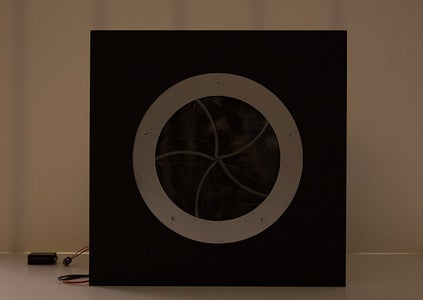

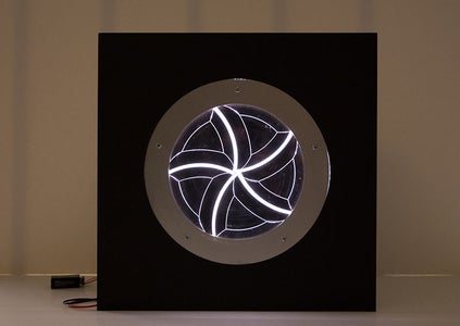

Step 7: Lights On, Lights Off!
Ta-da! You can see that the beveled edges are still visible, but there's certainly a high contrast between the off and on state.
In the end, we wound up not even making a an iris door for the final project, but we still wound up using the effects of sanding and beveling acrylic for the door we did make!
