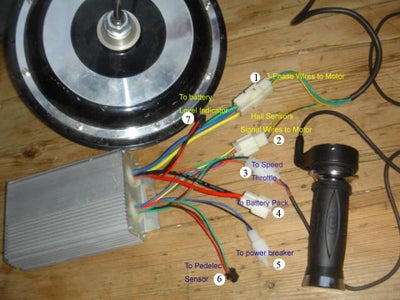

First, let's sort out the motor's wiring. There are eight wires, or leads, running from the motor. Three wires power the motor and are larger (16 AWG): Green, Blue, and Yellow. Two wires power the sensors and are smaller: Red and Black. And three wires connect the sensors to the controller: Green, Blue, and Yellow. For this project, we are concerned only with the smaller wires.
Now, there are two methods I've used to determine which of the three sensors failed. By the way, both require the motor to be fully assembled, so put the wrench away!
The first is to simply run the motor while one sensor lead is disconnected, then again for the second lead, and a third time for the last lead. If one sensor is dead (and that's your only problem), you'll see that disconnecting one or the other of the good sensors prevents the motor from turning altogether, while disconnecting the bad one has no effect at all--it still sputters. If this works, great. You've identified which sensor needs to be replaced. Remember which lead it is head to the next step.
If that didn't work, try this second method. It is more complex, but useful to identify more nuanced issues or problems stemming from multiple failures.
Prepare a firing order table on a spreadsheet with as many rows as there are magnets (46 for this model motor) and 4 columns. The first column should contain the switch point (1 - 46) and the remaining three should be used to record sensor output from each of the three leads. While the motor is connected to the controller, powered, and at rest--or, alternatively, powered with +5 volts from a workbench power supply--set up a multimeter to monitor the sensor's output. Record the voltage change between the sensor ground and sensor lead as the wheel is slowly turned.
In a perfect world you would use three multimeters and mark your readings from precisely the same point for each sensor. You, like most people, have at most one multimeter, so use masking tape and a felt-tipped pen to mark 46 points around the motor at which to take readings to ensure they correspond for each sensor. Once your table is complete, your problem should be apparent. If not, add an additional three columns to your table and preform a similar test on the larger power leads, but check for continuity instead of voltage change. If it is still unclear why your motor is not working, find help online at the Golden Motor owner's forum or elsewhere.

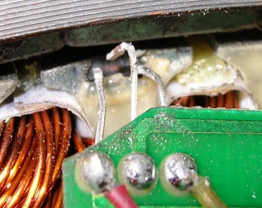

As you can see in the picture, the leads and sensor board are secured to the stator yoke spokes with small cable ties. Use your wire cutters to cut the ties and free the sensor board. With your soldering iron, or solder wick, remove the solder from all five leads and push them to the side. This should also free the sensor board, which you should set aside.
With your pliers, pull the bad sensor (or all three, if you want!), clean out the sensor well, insert the new sensor, and glue it in place (the glue is optional). Replace and solder the sensor board, then the sensor and power leads.
Here, it is wise to test each sensor lead for continuity using your multimeter from the end of the lead at the controller all the way up to the body of the sensor. While checking for continuity, move your leads around to be sure there are no intermittent breaks. If you find any, repair or replace as needed.
Secure the board and sensors with new cable ties and test the sensors once more. Before you put the cover back on, check to see that the sensor board doesn't sit so high that the board will make contact with the cover.
