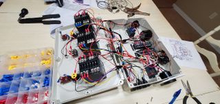

Step 6: Wiring
The final step is to wire everything up. This is where attention to detail, a steady hand, and a ready supply of curse words can come in handy. Make sure everything is unpowered when you are wiring, be safe, and understand what you are doing. Releasing the magic smoke from inside electronic components is not a good way to reduce system cost.
A lot of the wire in the control panel is heavy duty to carry large currents and is thus hard to work with. When using terminal strips you may find that it helps to tin the stripped ends of the wires. Crimping on ring and spade lugs will be required so pick up a crimp tool when you buy your lugs. The attached pseudo-schematic gives you an idea of what you want to do. In the schematic, thick fat wires are heavy duty 10 gauge for the 30A heaters. The rest are drawn with thin lines and can use smaller wire like 20 or 22 gauge since no appreciable current will be carried. However, the wires for the pump switches and outlets are drawn in medium weight because they should be 14 gauge since the outlets are rated to 15A and you may be plugging things into these outlets such as pumps, fans or the occasional vacuum cleaner that may draw a significant current.
The terminal strips were converted into "Bus" strips by using short sections of solid copper wire that short the terminals together as you can see in the photo of the interior wiring. Be sure to use a heavy duty wire, in this case 10 gauge for the hot bus and might as well use 10 for the neutral bus.
Another method to cut down on the number of wires running around your enclosure is to use the ring or spade terminals to accept more than one wire to allow you to avoid running a single wire for each need. In the case of the PID controllers you can see in the wiring photo that I've daisy chained the hot and neutral wires at the spade lugs to cut down on wires.
Be sure to have a good single point ground for the heaters and the outlets. If your enclosure is metal, ground it too. Also grounding the housings of metal components such as the key switch or the toggle switches is a good idea. Bring these grounds to a single point, which in my case was a bolt that I put all the ground ring terminals on and tightened them together. You can see this bolt in the lower right of the interior photo.

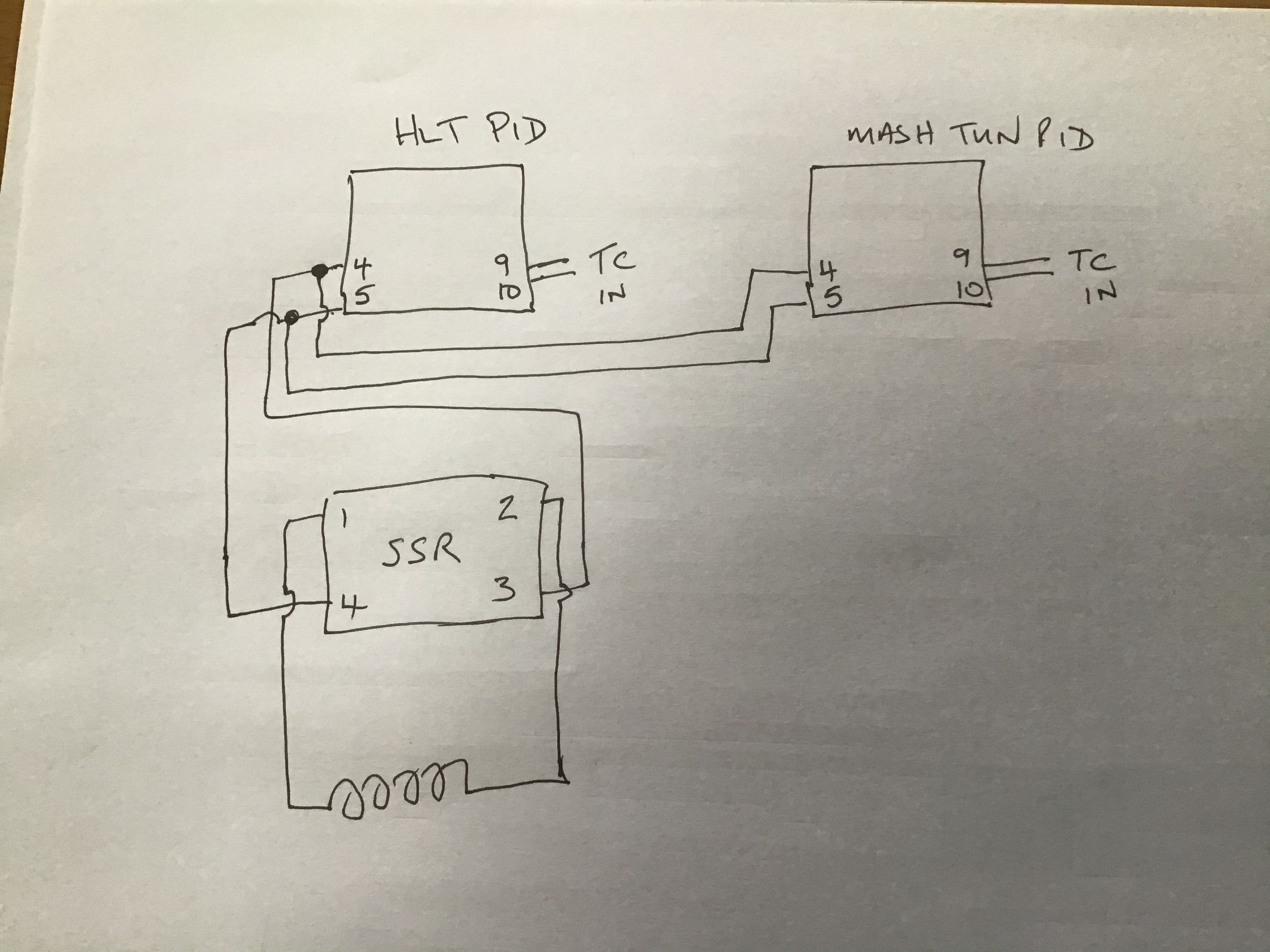

Question 3 years ago on Introduction
Hi, I’m building a similar system. I will have a PID for the HLT temp and a PID for the Mash Tun which at the moment will only tell me what temp the Mash is. I was wondering if I could connect the output of the MASH PID to the output connections on the HLT PID to control the temperature during the HERMS recirculating process based on the mash temp.
Answer 3 years ago
I'm not familiar with the specific output characteristics of your PIDs, but theoretically both could be connected to the SSR as it is a logic level signal. In practice however the PID control function would be compromised by "too many chefs" working at once and you may find temperature regulation will suffer. Best to have a DPDT switch to control which PID outputs are "in charge" at which time. Good luck!
Reply 3 years ago
Thanks very much for your “input”. Temp regulation is the key here so any compromise is a no no. I may try it but at the end of the day it may just be a case of monitoring the mash temp and just upping the set value on the PID manually. Was sort of trying to automate it but no good if it can’t be trusted.

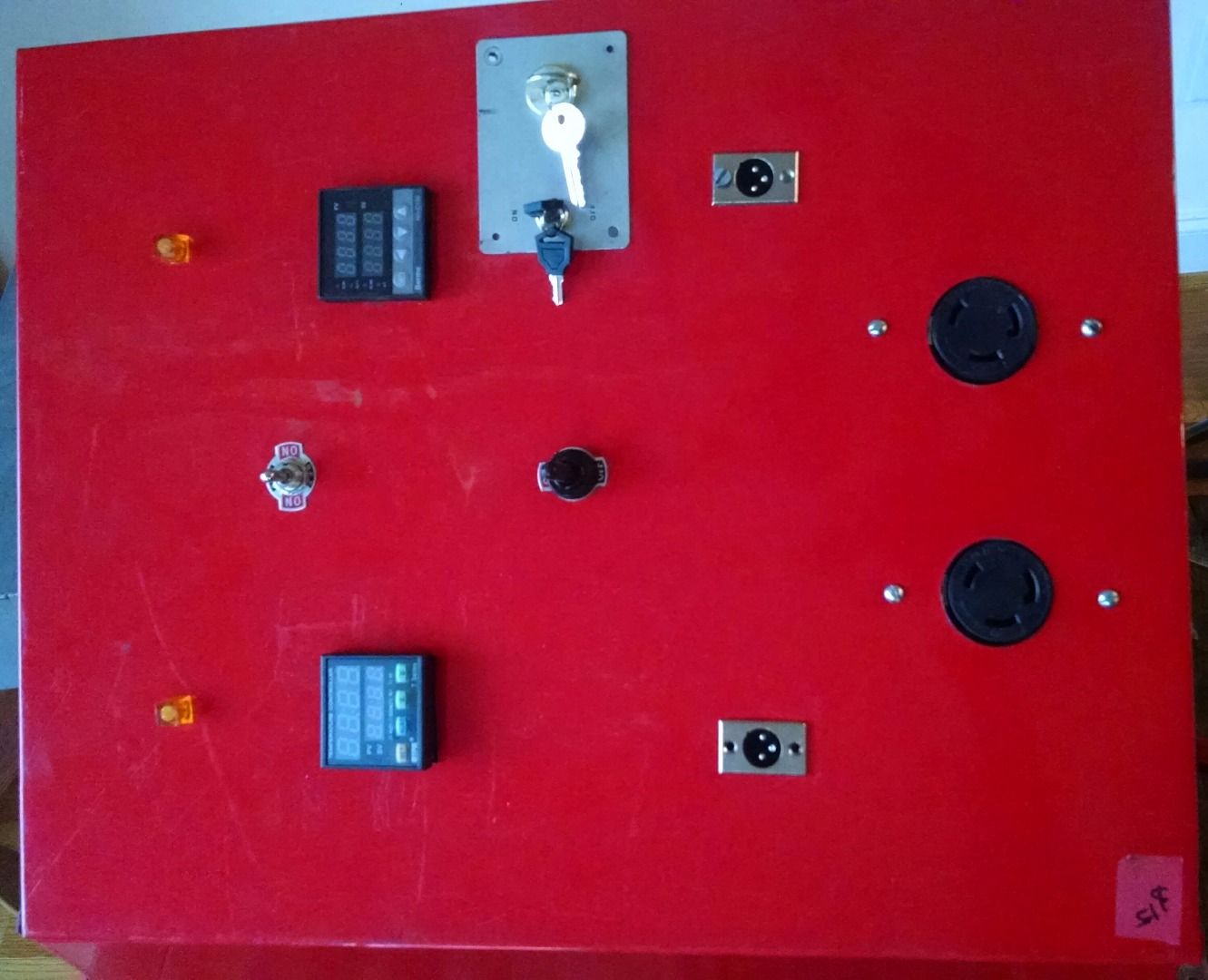

5 years ago
Hi. Slowly collecting the parts and pieces to begin phase 1 of this build (BK control only). Wondering about the wood enclosure. Seemed reasonable to me, but have been seeing conflicting opinions about safety. Considering your rig looks worn and you're still answering questions about this post, I'd have to guess you have had no heat/fire/carstrophic failure issues. Any comments about your experience with heat generation of the SSRs and damage/impact to the wood enclosure?
Great post and guide! Many thanks.
Bryan
Reply 5 years ago
The wood enclosure does soak up spills and splatter, so gets more worn with use but otherwise has been fine. Keep it clear of the messy processes and you should be ok, it certainly isn't water tight. In terms of safety, definitely a good GFI breaker is needed with proper grounding where applicable. Never had a problem myself. Also, the heatsinks for the SSRs are outside the wood case and never get very hot in my experience. The failure mode we've had is with the PID controllers. All the original units have failed and we are now using a better quality unit only on the HLT with a simple PWM controller on the boil. Good luck!
