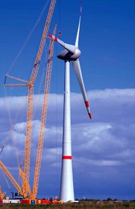

The quest for creating a revolutionary wind generator that has the potential to compete with fossil fuels starts with the wind. Modern wind turbines like the Enercon E-126 is highly engineered. Standard tower to turbine systems, no matter how highly engineered they are, have limitations. First, they cannot rise above 500 feet. They are tied to the constraints of a tower. They are heavy and extremely difficult to transport. They are expensive, and not cost effective enough. They do not produce enough power to be competitive with fossil fuels. Modern wind turbines are getting larger and larger, it seems they have reached their height limitations. Some say “the wind turbine,” is the most efficient design for converting the motion of the wind into mechanical or electrical power. I am here to tell you, it is not.

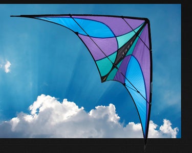

Looking at kites, one of the best retailers I have found is Prism Kites [1]. They have very well made kites, and my experience with them has been pretty positive. Looking that the sport kites they sell, we can see the variety they have. For this project, you could use any of their sport kites, but the one that I prefer is the Jazz.
"Simple, rugged and affordable, the Jazz outperforms every beginner stunt kite in its class. It’s a zippy little wing that packs up small so you can take it everywhere. Leave it in the car, at the beach house, strapped to your motorcycle...because you never know when you’ll get the urge to fly.
The Jazz’s deep wing profile and tough hybrid glass/carbon frame means you can safely hand it off to anyone for a test drive. In the air, it’s quick but remarkably stable and easy to control, even for a low-time pilot. Engineered and built to the same obsessive standards as our top-end equipment, it’s a simple, compact little gem that will get you up and flying with a grin.
Designed for beginners, the Jazz has a 55-inch wing span but folds down to 25 inches long so it can be packed in a suitcase or backpack. Easy instructions are printed on the case so they're always handy. Quick, stable, and easy to control, the Jazz will fly in winds as low as 5 mph, a plus for inland pilots, and also perform in winds up to 25 mph for trips to the beach. The ready-to-fly package includes two 65-foot low-stretch Spectra lines, winder, and flight straps." - from prismkites.com

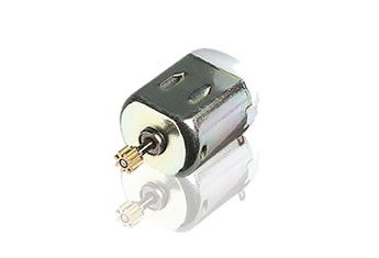

The next thing we need is the generator. Now, going back to simple electronics we know that an electronic motor can also function as a generator for electricity by working in reverse. For this project, we can go cheap and use a hobby electronic motor from Radioshack. [1]

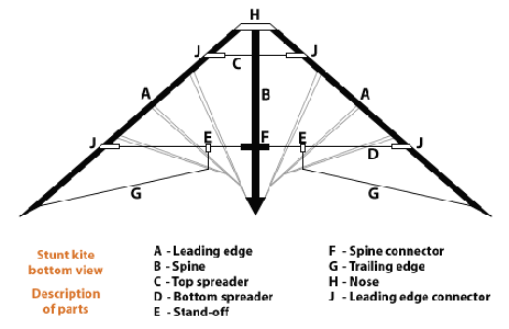

Take your rod of carbon fiber and cut it into 2 one foot pieces. These will protrude from the leading edge of the sport kite and will be the place where the turbine and generator is mounted. Attach one end of the rod to the leading edge connector (J) with duct tape, and the other end to the leading edge (A). Refer to the parts of a sport kite in the image below.
The rod should protrude from the leading edge about 7-8 inches in such a way that the tip of the blade does not hit the leading edge. This will provide a sturdy spot to mount the generators.
Next, tape a majority of the motor to the end of the carbon fiber rod as seen in the picture. I used a 1 inch dowel to provide a sturdier mount, and you can do the same but it is not necessary.
