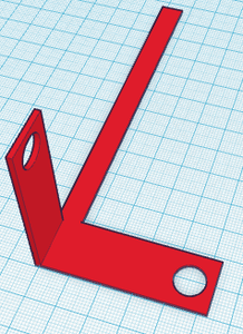

I was putting some rope lights into storage a while back and noticed how it seemed the rope lights would fit inside 1/2" PVC pipe and thought If only I could find a nice looking bracket that did not look like PVC fittings. The included files will allow you to create a system for your own room.

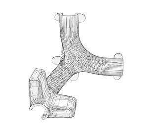

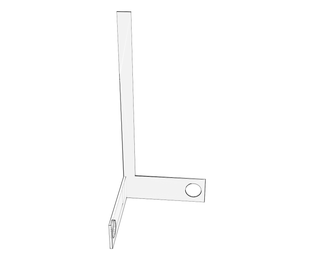

- Printed brackets. files attached (an average room would require at least 4 corner brackets and 2 or 3 connector brackets spaced between along the wall)
- 1" drywall screws
- Bonus: printable templates (files attached) for marking where the screw holes need to be spaced and distance from the ceiling

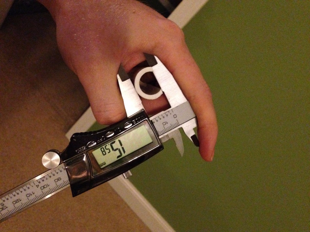

First, decide how many bracket parts you will need for your room. As your parts are printing, you can gather and cut the 1/2" PVC Sections. Please note that I cut the top section off my PVC pipe to direct light toward the ceiling and allow the rope lights to snap into the pipe. The photo above shows a side profile of a pipe section that i have cut the top off. You could set your table saw for 15 or 16mm thickness cutting just the top off that includes any writing or bar codes. (I would advise extra caution and safety with this step and perhaps setting up a jig to guide the pipe through for cutting)

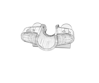

Now that you have the brackets and pipes ready to install, use the handy templates for marking the ideal placement of 1" screws on your drywall. Drive the screws so the head is still sticking out from the wall. the brackets are designed like picture frames or shelving that is meant to hang on the head of screws and has the recieving holes designed into the back of the brackets.
Snap or slide your pipe sections into the brackets and you are now ready for the last step of inserting your rope lights!

If everything works as desired, you can glue the brackets to the pipe sections with (you guessed it) PVC Cement to make everything more secure. (I also coated my bracket parts with XTC-3D just to prevent any delamination or breaking during installation)

Printed these files without any vertical supports. There are some tabs on the base that you can break off as I printed these parts in PLA on my machine and found that it helped secure the parts to the build plate for printing.
Do not scale these parts as they are sized to accept the PVC pipe inserts!
