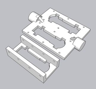

A dual channel with cutouts and matching screw holes was designed to hold two of the Servo Gearboxes, which are the hip motors. The bottom of the dual channel has some alignment ridges and holes to fit ¾ inch angle aluminum, with 1/8 inch walls. A second dual channel is attached to the angle aluminum towards the rear for the back hips.
The Servo Gearboxes have a one inch diameter mounting hub in the center of the large gear with four threaded screw holes for #6 machine screws. The base support (refer to the images) has a short mating one inch diameter shaft which is attached to the Servo Gearbox mounting hub using #6 machine screws. At the back end of the base support is a short shaft, aligned with the front short shaft, which is supported by a ball bearing. The front shaft is also supported by a bearing, with a bearing brace that is mounted using the screw holes in the dual channel.
A downside of the Servo Gearboxes is that the drive shaft is not as ridged as desired, and has a small amount of give to it. This gets amplified when attaching the weight of two additional Servo Gearboxes, and their mounts, along with the leg and all the forces on it. With the additional two supporting bearings the mount is much more rigid.
The two individual channels that are attached to the base support have small brass M3 inserts in the bottom and are attached with flat head M3 machine screws through the base support. These individual channels are mounted after the base support is attached with machine screws to the Servo Gearbox mount hub to allow for clearance.
The top individual channel on the motor mount frame will hold the Servo Gearbox that moves the femur, or top portion of the leg. The bottom one holds the Servo Gearbox that moves the tibia.

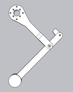

The femur has a circular mounting area at one end that is screwed directly onto the large gear of the Servo Gearbox and moves independently of the tibia’s movement.

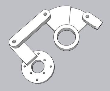

The drive for the tibia is more involved and consists of a pantograph crank mechanism, the long sides are the femur and a threaded rod attached to the crank arm and the end of the tibia. The short sides of the pantograph mechanism are the crank arm radius and the top portion of the tibia. A crank is mounted on the tibia Servo Gearbox and connects through a crank link to a fan shaped crank arm that rotates on a short shaft screwed into the central hub of the femur’s Servo Gearbox. The crank arm rotates on two side by side bearings. The outside diameter of the bearings are press fitted into the crank arm and the inside diameter of the bearings accepts a short shaft mounted onto the central hub of the femur’s Servo Gearbox. These bearings allow the tibia arm to move independently of the femur.

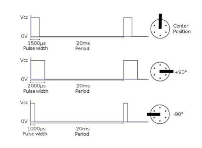

Step 7: Software - Servo Signal to Position the Motors
A radio control (RC) type servo motor is controlled by sending it a continuing pulse train. Although servos differ slightly by company, in general the servo’s center position is obtained by sending a 1,500 microsecond pulse to the servo every 20 milliseconds. In general, sending a 1,000 microsecond pulse every 20 milliseconds turns the servo head 90 degrees to the left and a 2,000 microsecond pulse 90 degrees to the right. The Servo Gearboxes, with their geared arrangement, use slightly different values. The speed the movement takes depends on the servo’s speed specification and the voltage used, which is normally in the range of 4.8 to 7.4 volts.
Servo City’s Actobotics SG12 Series Servo Gearboxes allow for more rotation because of their geared system. The home position is at 1,500 microseconds, and they turn 0.321 degrees/microsecond, or 1.0 degree with a change of 3.115 microseconds. Setting a gearbox to a specific angle from the 1,500 microsecond center position is done by multiplying the angle by 3.115 and then, depending on the desired position, adding or subtracting from 1,500 to get the pulse width needed. Servo City’s Stingray series has different values for degrees/microsecond.
