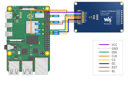

For touch sensing capabilities on the robot's head, we incorporated a compact capacitive touch sensor, which fits perfectly in the designated area. The central component of the head section is a 2-inch IPS display from Waveshare, responsible for conveying the robot's emotions. To secure the display, we utilized black supporters and a small amount of hot glue. To enable audio playback, we integrated an 8-ohm 0.5-watt speaker on the left side of the head, accompanied by a PAM8403 amplifier for sound amplification from the Raspberry Pi.

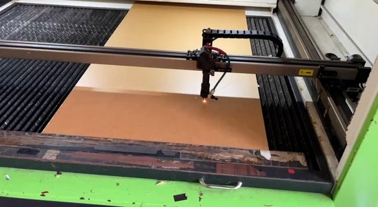

To complete the assembly, we secured the Raspberry Pi to the back of the body using screws. Additionally, we used a 2mm transparent acrylic sheet at the front end to conceal the gap between the outer cover and the LCD module. This acrylic piece was created using laser-cutting technology at a local shop. We provided them with a DXF file of our design, which was obtained from the design.
Step 7: Circuit
The Emo robot has been built according to these circuits.
