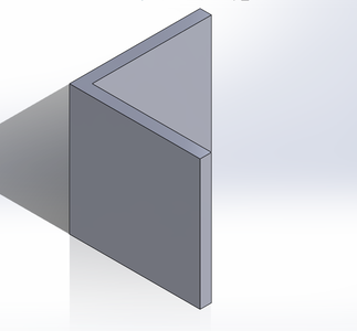

Step 2: Bottom Back
For the bottom back two pieces, cut a piece out which is .50in away from the back and from the side (It does not matter which side, as long as two sides get completely cut).

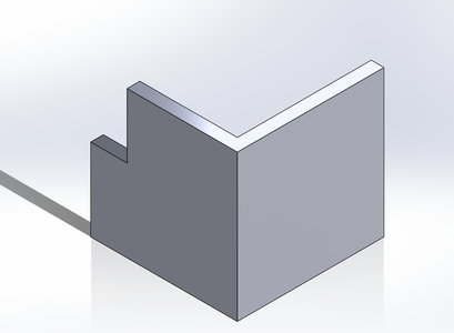

Step 3: Front Left
Repeat the same process for the front left part. After you make the first cut, cut out another piece on the front part of the newly created shape. It should be 2.53in tall and 1.43in wide.

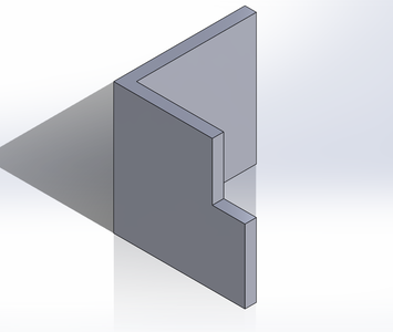

Step 4: Front Right
Do the same exact process as steps 2 and 3 but make the cut from step three on the opposite side.

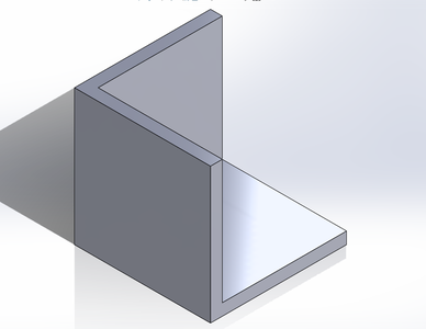

Step 5: Top Back
For the back two pieces on the top, use the same base as in step 1 and the same process as step 2; however, instead of cutting all the way through, only cut 5.25in through.
