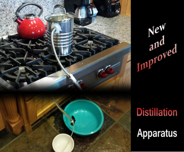

Two problems were apparent in my last attempt - first, the tube began to droop and deform under the heat, and second, the tube's slope wasn't great enough for gravity to pull the condensed distillate out unless it was fairly full. The two-segment condenser is my solution to the first problem. As it stands, the first condenser tube (the sink tube) is only cooled by air, which could be improved with a simple heatsink from aluminum cans or foil or by simply wiping it with a cool wet cloth periodically. My main concern for this first tube, though, was just to put some distance between the plastic tubes and the heat source, and it does the job nicely.
For the second problem, merely finding a taller condenser bath than the plastic nut jar I used last time so I could give the distillate tube a steeper declination would mean I'd have a much larger apparatus. That could be somewhat inconvenient, and I had already had some trouble dealing with how everything must be positioned in my previous apparatus. As I thought about how to deal with this, I had a new idea: why not put one tube carrying the distillate inside another carrying the ice water? This not only makes it easy to store but also allows me to position things however is most suitable for where it is being used rather than having things fixed in place.
Step 6: ​Prepare the Distillation Vessel
Once I had gathered all my materials, I found a drill bit that matched the size of the nipple and drilled a hole in the coffee can. Since the can flexed as I began to apply pressure with the drill, I put in several pieces of scrap wood to hold its shape. The nipple is then screwed into this hole.
Step 7: Assemble the Condensing Chambers
Next, insert the small distillate tube into the sink tube and caulk it if necessary. In my case, the fit was tight enough that it wasn't. Then take the larger condenser tube (the 1/4" tube, in my case), cut it to be as short as or a little shorter than the distillate tube, and drill two holes in it - one near the top for the coolant (ice water) to be funneled in and another near the bottom for the distillate tube to exit through. Thread the distillate tube through the condenser tube and out that latter hole you just drilled and slide the condenser tube up until it connects to the sink tube. Finally, put your spigot or valve in/on the end of the condenser tube.
Step 8: ​Seal Things With Caulk
Use caulk to seal any gaps where the can and nipple connect, to fix the sink tube and second condenser tube together, and to seal around where the distillate tube exits the second condenser tube. If you have a spigot or valve that fits only loosely into or onto the end of the second condenser tube, use caulk there too.
Step 9: ​Test That Puppy
Since I have neither a hot plate (though I do have an iron that could be substituted) nor the right kind of thermometer yet, I tested it with good old water on the stovetop. For most other applications, of course, I'd need to control the temperature of the distillation vessel carefully.
As before, I used conductivity as a quick-and-dirty test of its performance. Putting an equal volume of the original tap water in an identical container, I checked the distilled water first. My multimeter detected no current! To double-check, I repeated the test on the tap water, and the multimeter overloaded - whoops, note to self: add a resistor next time. In spite of a possible blown fuse, I'm excited to call this one a success!
