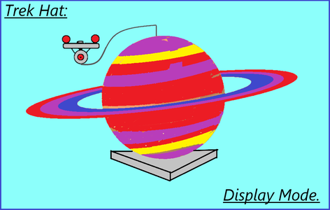

With the above factors considered, some plans were drawn up to give me an idea of how it would look, making notes of anything else that needed to be considered or worked out. Lets begin making our hat.

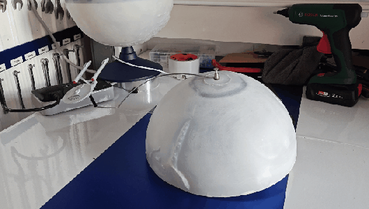

This is where we will use the second dome which we already prepared earlier. To make the hat stand, I used the base of an old table lamp, but you could also use a block of wood or anything that would be suitable. I also used some black scraps of plastic sheet. I used this as it is all I had to hand. Ideally I would have liked to use a clear or opaque plastic for the internal light strip to shine through.
We will start making the lip for the hat to sit over.
  1. Using a piece of scrap plastic, cut off a strip or some strips about 4cm wide and long enough to go around the full inner diameter of the dome.
  2. Rub down the strip with sandpaper to score the surface, then wipe clean with a damp cloth.
  3. Now apply hot glue to one half (lengthwise) to the strip and attach to the inside of the dome so 2cm is attached to the dome, and 2cm is overhanging the dome edge. This is there the hat halve will sit over, keeping it in place. Start by gluing a small part at one end to help hold the strip in place and making attaching the rest of it easier. Glue the strip in sections as the glue may cool down before you get to attach it.
Now to fit the LED light strip.
  1. Place the dome up side down onto a roll of tape or similar to support it. Then make a small hole to feed the LED strips power cable through. The hole should be located near the top of the dome (which will be the bottom when turned the right way up), and what will be the back of the hat stand (what will be facing away from you).
  2. Feed the power cable though the hole from the inside.
  3. Then start to peel back the adhesive backing from the light strip, and start attaching it to the inner hat stand lip. Follow it all around the lip until fully stuck down, then connect to power to test.
And now to attach the dome to the base.
  1. Make a hole in the very top of the dome (either drill of melt with a soldering iron).
  2. Make a hole through the base if it doesn't already have one, and feed a bolt and washer through it.
  3. Place the dome over the bolt, add another washer and screw a nut to fasten the dome to the base.
  4. Put the newly made hat stand onto your work surface and place the hat on top for test fitting. The take it apart ready for painting.

  1. Place the bolt and washer through the bottom of the hat stand base, then put the dome into position over the bolt, put the other washer on and screw the nut down.
  2. Before you tighten the nut and bolt, make sure the dome is sitting straight and that the LED power cable is at the back. Once you're happy, tighten them up (not so tight where you could damage the bottom of the dome).
  3. And a nice little bonus job. My Enterprise model came with a little black stand that's in the shape of the Starfleet insignia and you may have noted in the painting step that I painted it yellow. When the paint was fully dry I rubbed down the edges to make them black again, went around the edges with a black marker pen, then glued it to the front of the hat stand base. A nice and free little finishing touch.
  4. Before attaching the Enterprise, put the hat onto its new hat stand and test the lighting to make sure that not only the lights still work, but you're also happy with the way your new planet looks illuminated.
  5. And now attach the rod to the motor shaft making sure it is in the correct position, and finally attach the USS Enterprise ready for its official maiden voyage.
All that remains is to don your new headwear, press the motor switch, and have some fun. And then place it on its hat stand and see your orbiting wonder in action for yourself. All that's left to do now is to add that recognizable theme tune.
