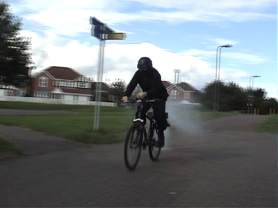

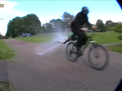

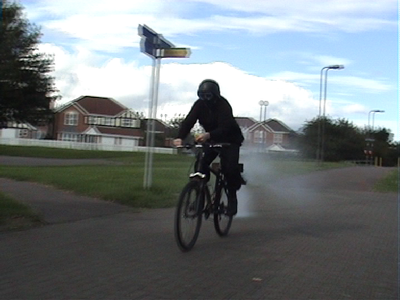

Step 9: The Event.
It's probably better to go to the video on the first page for the end result but here are some stills.
That's one spurt  for man but one giant gush for mankind.
