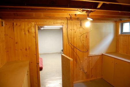

Step 5: Demolition - Tearing Down Walls
At its most basic level, demolition consists of one basic rule: smash stuff until it's lying on a heap on the floor. But, we are not so primal, so here is a more civilized way to go about it.
1. Start by removing anything from the space that isn't nailed down. The only thing that should be in the room you're tearing out should be the tools you need for the job.
2. Shut off the power to the space. Turn off the power at the breaker or fuse panel. Better yet - turn off the power to the house and remove the space you're working on from the circuit entirely. This will keep you safe as you smash through walls, remove electrical fixtures and cut wires. Once the power is off, go around with a circuit tester and MAKE SURE there is no power present. From now on, your power tools will be running on extension cords plugged in elsewhere in the building.
3. Start smashing! Remove everything down to the concrete walls and floors - it's better to redo everything. It will also allow you to inspect the foundation for cracks and leaks - issues you'll want to fix before going any further. Most of the stuff you tear down can't or shouldn't be used again. Here is a short list of stuff you're likely to remove, and whether you should bother keeping it:

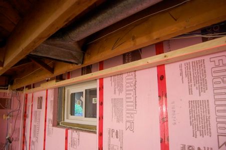

Step 8: Insulation - Intro

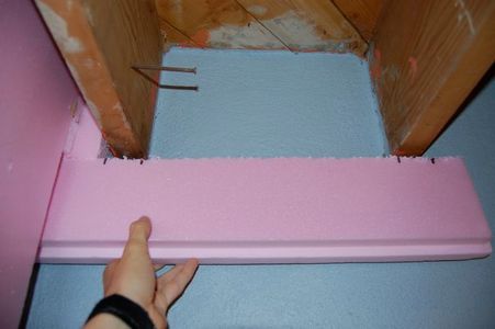

A few months before starting on my renovation project, I had an energy evaluation done on my home. The results were surprising, especially concerning the basement. As it turns out, most of the heat leaking out of the house was leaving through the basement walls, especially the section between the ground outside and the main floor. Just 18 inches of concrete wall above grade was responsible for 25% of my heat loss! Obviously, insulating the basement walls makes all kinds of sense.
Unfortunately, insulating a basement wall is not as easy as slapping on some fiberglass batting. There are issues of moisture to contend with, and if you don't do it properly then you risk setting up a perfect little habitat for growing toxic mold.
THEORY:
Concrete, despite its ability to crush your foot most effectively if dropped, is not solid. It is porous to water, and conducts heat pretty well, too. Drywall, vapor barrier and fiberglass insulation also permit the movement of moisture, though to a lesser extent. It is important to remember this, because it means that moisture can enter from both sides of the interior wall - from the moist ground outside, and from the moist air inside!
The goal here is to minimize the buildup of moisture between the concrete wall and the inside of the walls you're about to put up. That means you have to do two things: Prevent moist interior air from reaching the cool concrete wall (thus preventing condensation), and preventing moisture that seeps through the concrete from building up inside the wall.
After doing tons of research, I found the answer. What we're going to do is paste styrofoam panels directly onto the wall, creating an airtight barrier around the perimeter of the exterior walls. Moist warm interior air will not be able to reach the cold concrete walls, and the moisture that seeps though the concrete is stopped because it has no air gap to evaporate into. In addition to this, the foam inhibits mold growth adding further protection. No vapor barrier is needed!
HOW MUCH INSULATION TO USE?
In my case, I used three layers of insulation. I started with two layers of foam insulation, 2 inch and 0.5 inches thick, staggered for maximum restriction of air movement. Once the stud walls were installed I stuffed in 3.5 inches of fiberglass insulation. This provides an R-value of 27 on the top half of the wall, and R13 on the bottom half.

Step 9: Insulation - Pasting on Foam Panels
Before you start, make sure the walls are clean and dry. If you're planning to expand the windows to comply with building codes, do all that first. If you have plumbing running directly along the wall, move it out a bit if you can. You don't want to bury pipes under layers of insulation.
The process is pretty simple. The 2" foam panels will have lips along the long ends that are designed to fit together. When you measure each piece of foam, make sure that the panels are aligned properly for a good fit. Simply measure the space in which the foam panel will fit, and mark out anything that needs to be cut out. Try to leave as small a gap as possible between the edge of the foam panel and any surfaces it butts up against.
Dry fit the foam panel, and trim as necessary. When you're satisfied with the fit, grab the caulking gun with foam adhesive and lay a 1/4" bead in a wave pattern along the back of the foam. Stick the foam into place, then gently peel it back again. Leave the glue "open" for a minute or two before sticking the foam back onto the wall. This process aids in fast and proper adhesion.
Now, just work your way around the room, filling the entire outside wall surface with the foam panels.
If you're putting on a second layer, as I did, the process is the same. Measure, cut, fit, glue, and stick. When fitting the second layer, make sure that it totally overlaps the seam of the layer beneath. This will further reduce airflow and improve the performance of the panels. Go one step further and seal all the seams with Tuck Tape.
The insulation step is done for now, until the framing and electrical are installed.

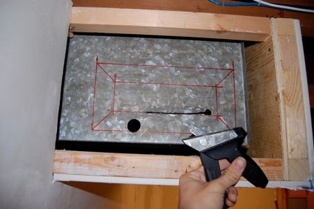

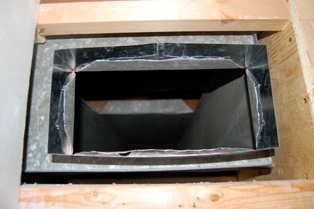

Step 15: Framing - Building a Soffit
The big, ugly return air vent cannot be allowed to make itself seen in our beautifully finished room! It will be enclosed in something called a soffit - a frame built around the vent that can be covered in drywall. This same method can be used to enclose steel H-beams, vent pipes, water pipes and other ugliness that would detract from the look of the room.
The soffit is built on the ground and then lifted into place. First take careful measurements, making sure to leave a bit of space between the inside edge of the soffit and the vent. Also remember that the wall underneath the soffit will need to be specially constructed, since the top plate can't be screwed to the ceiling - it will be secured to the wall instead.
The soffit is constructed of 2x2s, 2x4s, and half inch plywood. Start by cutting a piece of plywood that extends from the ceiling to down below the vent. You may need to place more than one piece end-to-end. Then screw 2x2s onto the edges on either side of the plywood for the entire length. This will create a rigid, perfectly straight cover for the face of the vent.
Next, create the "top plate" for the wall beneath the vent, which will extend the length of the soffit. This top plate will eventually be supported by studs on either side of the vent and by supports anchored into the wall. Between the top plate and the plywood piece, cut short pieces of 2x4 that rest on top of the top plate, and attach to the back of the plywood cover. Very careful measurement is required here!
With the aid of a helper, hoist the soffit into place over the vent, and screw it into the ceiling joists and onto the studs at either end of the soffit. It should now support its own weight. Finish the wall below the soffit by installing studs as usual every 16 inches.
To make the stud wall beneath the soffit stronger, use some scrap pieces of 2x4 to build a bracket. The bracket should be anchored to the wall using Tapcon screws, and screwed onto the stud close to the top plate. Use one or more brackets depending on the length of the soffit.
There you go - the soffit can now be drywalled just like any other wall!

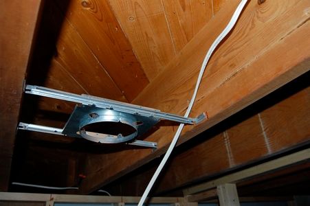

The inset pot lights I used my renovation used their own special junction box, which was mounted directly to the light fixture. The fixture attached to the joists in the ceiling using special brackets. If your lights are like this, then follow the supplied instructions.

First, measure the area where you want the vent to be. There are many different sizes of vent covers available, just pick one that first best. With the vent in hand, decide how large the opening in the duct should be. In my case, it was the area in the center, not the outside edges! Transfer those dimensions to the duct using a permanent marker.
You will need to install a small duct that runs just from the edge of the main duct, to the vent (which, in turn, rests on top of the drywall). So that you have something to attach that duct onto, you'll be cutting tabs into the main duct. Inside the rectangle you drew on the duct, draw a smaller one about 1" smaller on each side. Then, draw lines between each of the four corners.
With the drill, cut a hole on each of the corners of the inner rectangle. Then, with the shears or nibbly cutter (whichever works best for you), cut out the smaller inner rectangle. Then, cut along the diagonal lines that link the corners of the two rectangles. Fold the tabs outwards as neatly as possible, and try for a clean 90 degree bend.
Cut a small piece of sheet metal to act as a bridge between the hole in the main duct, and the vent. It should be made to fit tightly around the outside of the tabs, and wrap all the way around. You may want to leave this step until you're ready to install the drywall.
Now, go off and install the soffit around the ductwork as described later in this instructable. When it comes time to drywall the section where the vent will be, transfer the dimensions of the vent opening to the drywall surface. Then, cut out the opening. Fit the drywall in place, and slide the small piece of ducting you made earlier into place. Everything should line up properly. Screw on the drywall.
Using aluminum tape, attach the tabs to the inside of the small piece of ducting. Try to keep the tape as smooth as possible, and be sure to seal up any air gaps. Finally, attach the vent cover on top of the vent hole.

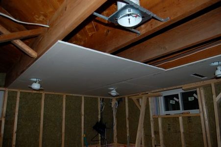

Step 23: Drywall - Mounting Sheets on the Walls
I actually think this part is pretty fun. Measure the space, cut the drywall sheet to fit, and screw it in place. Well, it's a bit trickier than that. ;)
I'm going to explain how to mount a sheet of drywall on a wall first, even though you typically start with the ceiling. The reason for this is that at the corners, where the wall and ceiling meet, it's a lot easier to get a sheet of drywall on the wall to fit perfectly. Thus, the drywall on the wall covers any gaps left behind by a sheet on the ceiling.

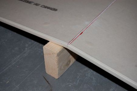

CUTTING DRYWALL
There are two main ways to cut drywall. Each has its benefits.
The first way is to score along the cut line with a utility knife, so that the paper and a bit of the gypsum are sliced through. A good, sharp blade is essential. Then, just snap the drywall board along the line. It happens very easily! With the knife, cut the paper backing to complete the cut. This results in a nice straight line with a relatively clean edge. The downside is that you can only do straight lines, and the cut must be from end to end.
The second way is using a drywall saw. Operation is simple - just cut the board with the saw. For interior cuts (say, to cut a hole for an outlet), you don't even need to drill a hole - just push the point of the saw through the drywall. The drywall saw also allows you to cut corners and curves in the drywall, but at a price. The edge is more ragged than a scored cut, and it makes a lot more mess.

Lay a sheet of drywall on the floor. Make sure the floor is clean, and that you have room to work all the way around. With the tape measure, first determine the exact height and width of the wall section to be covered. Note that with 16" on-center stud wall construction, a full sheet of drywall should line up perfectly with the studs, with the edge of the drywall lining up with the center of the stud. Transfer those measurements onto the finished side of the drywall. Reduce the height measurement by about 1/4", so the drywall can be elevated off the floor. Next, locate any outlets in that section of wall, and mark out where a hole needs to be cut for the outlet.
CUTTING DRYWALL

Step 24: Drywalling - Ceilings
Before I started, I thought drywalling a ceiling would be really hard. As it turns out, it isn't too bad. It certainly helps to be tall, too - my head is only 2 inches from the finished ceiling.
The process of drywalling the ceiling is very similar to the walls. Measure to fit, and screw in place with drywall screws. The trick is holding the sheets in place while you're working. It can be done if you're working alone, with the right tools.
MEASURING
This process is similar to walls, with one big difference: To make it easier, place the sheet face down on the floor, and mark dimensions on the back of the drywall sheet instead. For me at least, it's easier to picture how the sheet will fit on the ceiling, simply by lifting it straight up and into place. Mark height and width on the sheet, and any holes that need to be cut (say, for recessed lighting).
CUTTING
Cut normally, but be extra careful when you score lines. Make sure that when you snap the sheet, you don't tear away any of the paper on the finished side.
MOUNTING
OK, here's where things get interesting. The easiest and fastest way to hold a sheet of drywall on the ceiling is with two helpers. Simply position the drywall and drive in screws. You can even use the laser line tool for screwing onto the "blind" joists - if you position it back far enough, it will draw a line on the ceiling as well. Line it up with the joists on either side of the drywall sheet, and use the line as a guide.
If you're working alone or with just one other helper, you'll need to build something called a Deadman. It's basically a T-shaped support that is slightly taller than the height of the ceiling. It can be made with 2x4s left over from framing.
To use a Deadman, measure and cut the drywall sheet as above. Lift the sheet into place, and have your helper shove a Deadman under each end of the sheet. It should wedge in place and hold the sheet firmly against the joists above. Once the sheet is screwed in place, unwedge the Deadman and move to the next section.
You can do this if you're working alone too, but I don't recommend it. In this case, prop one Deadman up against the wall, and set the other one in a place where you can reach it from a standing position. Carefully lift the drywall sheet into place, and rest one end on the Deadman leaning against the wall. Quickly (before your arms give out), reach over and grab the second Deadman and shove it in place at the other end of the sheet. Align the sheet, and firmly wedge both ends in place. Screw in place with lots of screws before the crazy thing collapses on your head.

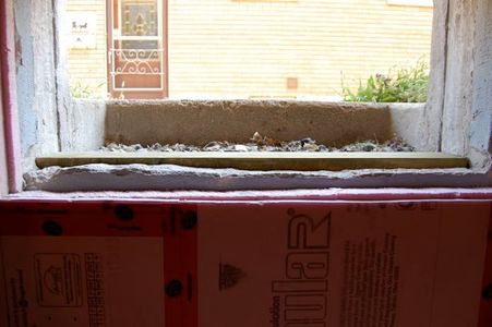

Step 36: Installing Windows - Dry-fit and Measure the New Frame
I advise against installing the new windows directly against the concrete. Instead, we're going to build a new frame out of pressure treated lumber, and set the window into that.
The windows I bought were customer returned units that just happened to fit perfectly. I was lucky. I suggest getting windows made to fit, rather than fitting pre-made windows into the space you've got.
The frame will be made of 2x6 pressure treated lumber. In my case, it was just about the right width to fit inside the wells left behind by the old frame. The lumber will be cut to size, glued in place, then screwed in place with Tapcon screws. I have pity for the next person who tries to replace these windows!
Start with the bottom sill. In my case, the width of the 2x6 had to be trimmed by about half an inch to fit. I cut it to the proper length first, then trimmed off the edge with the reciprocating saw (a table saw would be easier to use, if you've got one). Pop it in place to ensure a good fit. Leave it unglued for now, until the rest of the frame is finished.
Next do the top of the frame in a similar manner. Cut and trim to fit, and dry-fit the piece. Finally, finish with the side pieces, making sure they are a snug fit against the top and bottom parts of the frame.
With all the frame members dry-fit and holding together with friction, measure the new opening. Add about 1/4 inch to 3/8 inch to each dimension (1/8" to 3/16" on all sides) and order a window in that size. Chances are, the only window commonly available will be a double swing-out slider. Be sure to get a nice double glazed energy efficient window if you can.

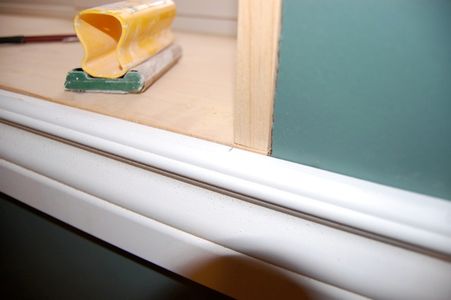

Step 38: Installing Windows - Build a Window Box
Once the framing is complete and the drywall is installed, you will want to install a window box to hide all the insulation, concrete and bare frame that are exposed. In my case, the box ended up being nearly 12 inches deep, thanks to the thickness of the concrete wall, the few inches of foam insulation, and the stud walls on top of that.
The window box should be made of something that won't be damaged by a little bit of water. Stay away from MDF and plywood - use solid wood like pine instead. At my local Home Depot, they had 12" wide, 3/4" thick jointed boards for a very good price.
I decided to install each piece on its own, though you may be able to build the window box on the floor or bench and slide it into place. In my case, the top of the window box actually slants up to meet the window frame, making it impossible to slide the box in.
Start with the bottom piece. Measure it to fit flush against the window frame, and flush with the edge of the finished (drywalled) wall. It will span the entire width of the window frame. Chances are, you'll be putting stuff in the window box, so use wedges under the wood to make sure the bottom is level front-to-back and side-to-side. When you're satisfied with the fit, nail it in place with finishing nails. If the box will be stained, you may want to glue it instead so there are no nail holes to fill.
Do the top next, in a manner similar to the bottom. Measure to fit, so the board is flush with the window frame and with the wall. In my case, with the angle on the top section, I had to precisely measure and cut the edge facing into the room so that trim applied to the window would sit flat. If you're nailing the top piece by hand, it's a good idea to start the nails on the ground. This will make it much easier to attach the board later on.
The sides go in last. Measure carefully, since the distance between the top and bottom may be different at the front and back of the window box (this is especially true if the top is on an angle like mine is!) Cut to fit, and dry-fit the sides before driving in any nails. As with the top, I recommend starting all the nails on the ground, then finishing them off with the board held in place.
When all four sides are finished, fill the nail holes and any gaps or knots with wood filler. Paint the window box with a paint that will withstand moisture - you never know when you'll accidentally leave the window open in a thunder storm!

The next step in installing the built-in shelf is completed during the drywalling stage. Drywall will be wrapped around the studs supporting the shelf, but not against the back.
Drywall right up to the edges of the shelf boards normally. Try to get the finished edge of the drywall to end here. Using scraps of drywall left over from drywalling the rest of the room, cut pieces to fit between the shelf boards, with a tight fit from top to bottom and reaching from the back board to the front edge of the drywall mounted on the walls.
Screw each small piece of drywall into place with drywall screws, or glue them in place with construction glue. There will probably be a gap between the pieces of drywall where they meet, which will have to be filled in. Start by taping around the shelves with masking tape. The tape will prevent any drywall compound from getting on the wood.
If the gaps are small, simply cover them with drywall tape, and drywall over the corner as you would any other corner. If the gap is large use some Durabond 90 first. Note that no metal corner brace is needed here, as there is little chance of the corner being damaged by falling furniture. Keep the masking tape in place until the walls have been painted.

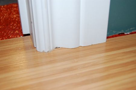

Step 46: Baseboards and Trim - Door and Window Trim Installation
Here is one task where you really have to take your time to get it right. It also helps tremendously to properly calibrate your saw for accurate cuts. When joining edges of trim or baseboards, you have to take a lot into account, including the angle at which the boards will meet, whether the walls are exactly 90 degrees to each other, and how baseboards may meet up with trim (say, at the door). Knowing those angles, you can set your saw to cut the trim perfectly - reducing repair work later and boosting your own pride!
In my basement I used two types of trim, baseboards and window trim (used on the door and the windows). The two are very alike, though the baseboard is slightly wider. The baseboards also come in 14 foot lengths compared to the window trim at 8 feet - make sure you have a way to transport it, and a place to store it!
It's a good idea to start with the door trim, since it's usually the easiest to install, and the baseboards butt up against it. Measure the opening with a tape measure and transfer the measurement to the trim. In my case there is no room for trim along the top of the door frame so I just did a 90 degree cut on both ends. If you have enough room for trim along the top of the frame, you'll need to cut the trim at 45 degrees at the mark. When cutting, you may want to cut the trim a little long (say, a few millimeters) and trim it down later if you need to. It's better to cut too long, than too short!
Fit the trim in place over the door frame, overlapping all but about a millimeter. Check to make sure that the corner cut at 45 degrees matches perfectly with the corner in the door frame. When you're satisfied with the fit, nail the trim in place with a nail gun. Make sure the nail penetrates the trim and a sufficient amount of drywall or wood - the trim should not pull off easily. If you're worried, you can glue the trim on first, but this shouldn't be necessary.
Window trim goes on in a similar way. Start at the bottom, cutting the trim at 45 degree angles on both sides so that the trim fits together like a frame. Again, measure very carefully, ensuring that the cut edges of the trim line up perfectly with the corners of the window box. When everything fits, nail it in place with a nail gun. As with the door frame, make sure the trim is firmly fastened to the wall.
When the trim is installed, you can cover the nail holes and any gaps with wood filler. When the wood filler dries, sand it smooth with sandpaper. Then, paint the trim in whatever colour you choose.
Step 47: Baseboards and Trim - Baseboard Installation
Wow, nearly finished! The baseboards are pretty easy to install - the trickiest part is cutting them accurately. With a compound miter saw, there are two ways to cut the baseboard, horizontally or vertically.
To cut vertically, the saw must have a large enough blade to cut the entire height of the baseboard. If it does, just set the saw to cut at 45 degrees (the same setting you used for the window trim). The baseboard is laid flat against the fence.
To cut horizontally, angle the blade on its side using the adjustment screw on the back of the saw. The baseboard is then laid flat against the table of the saw. If your saw is like mine, it only adjusts to 45 degrees in one direction, so you'll have to flip around the saw or the workpiece for some cuts.
With very long spans of baseboard, it's easier to mis-measure or lose accuracy. Measure the length of the wall with a tape measure and transfer that measurement to the baseboard, but add a few millimeters to the length. Cut as accurately as possible - when cutting horizontally, it's easy to mess up the cut by making it too short. Experiment with a piece of scrap board if you need to.
Hopefully, the few millimeters of length that you added will result in the baseboard piece bowing outwards when you try to fit it in. Just shave a few millimeters off the end of the baseboard until it slides in place perfectly. I recommend starting with the longest piece first, just in case you screw up - that way, you can still re-use it on a shorter length of wall.
When you're satisfied with the fit of the baseboard, nail it in place with a nail gun. I put a few globs of glue along the length of the baseboard for added strength.
When the baseboards are in place, you can go back along each piece and fill the nail holes with wood putty. Any gaps between boards can also be filled with putty. Large gaps may need more than one application of putty. When the putty is dry, sand it smooth with fine grit sandpaper.
And now, for the last big step! As with the window trim, paint the baseboards with a layer or two of interior latex in your desired colour. Be careful not to get any paint on the floor or walls - wipe off any specks of paint immediately with a rag.
