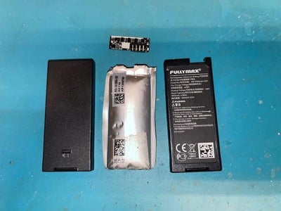

Step 1: Disassembly Original FullyMax Bat

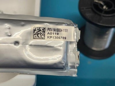

As you can see at the pictures, in this case my original battery was inflated after only 12 charge cycles.
The original FullyMax battery is rated at 1100mAh @3,8V max charging Voltage 4,35V usually LiPo batteries charge just to 4,2V so this additional 0,15V could be a problem, in my experience I didn´t notice after 5 charge cycles.
Open the plastic shell cutting along using a sharp knife or "cutter"
The most important thing is the charge and protection small board, please remove it carefully using a JBC low power 11w ironing solder or similar, adding some new free lead tin solder wires to the pads, will help melting old tin.

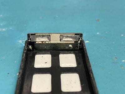

Step 2: Making a LiPo Battery Caddy
When you dissambly the original FullyMax battery shell, you get 2 plastic pieces, up and down, you have to left 15mm flange in the downside piece and cut the rest (as you can see at the pictures) in the upper side you cut a 15mm piece.
Get the normal LiPo battery connector and solder to the original protection board, respect the polarity according to pictures. You will see B+ and B- labeled in the small protection board
Joint together the 2 shell cutted plastic pieces with a piece of electrical tape and fill with hot glue
wait until glue is cold and remove electric plastic tape
Your Tello´s LiPo battery caddy is done !!

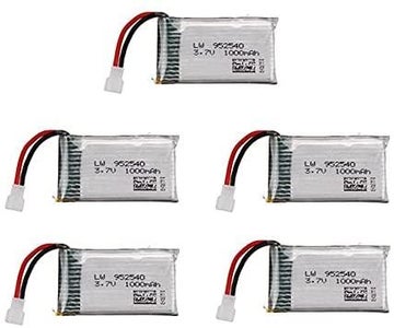

Step 3: Modifying LiPo Battery
I choose this 1000mAh LiPo because size compatible with Tello and is a 25C discharge bat, all LiPo's comes with a small protection board to avoid deep discharge and short circuit, in this case you have to remove this protection board because you will use original FullyMax protection board. (remember mark positive and negative terminals)
Next step is bend 2 Pcb board pins with the help of pliers
Solder this pins to the battery (remember you have to remove LiPo protection board)
You can connect the battery to the caddy
