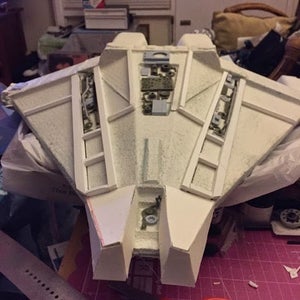

I needed to cut some material away by hand in the engine area to free up the ends of the engines from the ship. I could have made another part for this by flipping the model and having the engines point up but it would have been a challenge with the material depth of only 2"
An electric/heated knife would have helped a lot with this. the engines are kind of the weak part of my finished model.
Good source photos help a lot, I had a lucky break and got a response from a cold email to the model maker of the original film version of this ship- he sent me some photos of the the model when it was being built. I'd love to share them but I had to promise not to distribute them. You can see some of the detail 'greeblies' in the first pic from the film studio and the last pic of my model, these are the little parts from tank kits. Martin Bower does have a lot of pics on his site http://www.martinbowersmodelworld.co.uk/
Step 5: Sealing and Building Up the Surface
Foam is very hard to paint if you don't seal the surface, I sealed this ship with plain old elmer's white glue plus a little water added to thin it out. it covers great with a brush or even your finger and once dried you basically have a thin layer of vinyl that hugs the surface. Once the four parts were sealed and primed with flat white paint I glued them together with silicon glue. Hot glue is my usual go-to glue but it can melt the foam. I had to clamp the edges for the silicon glue and dented a few parts, I think if you use some card stock strips to spread out the pressure you can use clamps and clothes pins and avoid leaving indentations. I ended up rebuilding the nose with some card stock to sharpen up the edges and get a slight change to the geometry. (This ship's nick name is 'Miss Piggy' due to the twin engines in the nose. The original model has a tiny decal with a bomber art version of miss piggy.)
I added a lot of tank wheels and do-dads to the recessed areas. I lucked into some free 1960s tank model parts that saved me a lot of money, model kits are expensive now. I built up some lines on the bottom of the ship with strips of foam-core. Once these additions were sealed I sprayed the whole thing with flat white paint. the windows were hand painted with metallic blue model paint.
