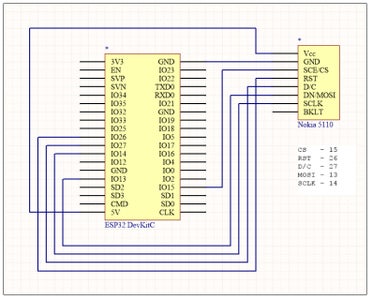

Step 1: Connecting Nokia 5110 to SparkFun Esp32 Thing Board
Connect the LCD pins as shown in the diagram

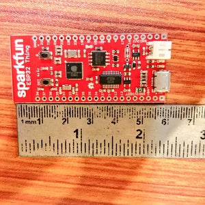

2. SparkFun esp32 Thing Board
