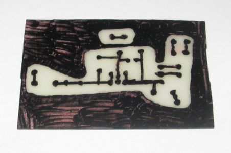

When I was sure nothing was going to happen I poured the etchant into the disposable bowl and placed the blank PCB board in the etchant. At first nothing happened and after waiting a while I added a little salt. Almost immediately the PCB board started to bubble, I added some more salt and you could really see the etchant start to work on the PCB board.
Step 7: The Finished PCB
When I started this experiment I was prepared for the results to be a royal flop. I expected elements from the pickles and spices that leached into the brine as well as the calcium chloride and polysorbate to interfere with the desired chemical reactions. To my surprise the etchant worked well.
The etchant did make its way through the Sharpie ink but I think most of that was more due to my poor application than the ink.

    Pickle brine is 1 part vinegar 1 part water and salt.
    I just had to boil off some of the water and see if the impurities interfered with the etching.

    I have to say that I've made tons of PC boards using the Ferric Chloride solution but never figured the pickle juice would work. Nice post.
    0
    Josehf Murchison
    Josehf Murchison
    Reply 5 years ago
    I read the Instructable using vinegar salt and peroxide and thought most of that is pickling brine.
    From there it was a left field idea, I was sure it would not work, but it worked.
