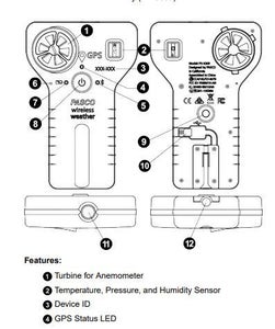

For my circumstances, I was assigned to monitor the temperature, humidity, wind speed and CO2 levels in SUNY ESF buildings so at a minimum I only need:
  • PASCO weather sensor (in the 1st picture)
  • PASCO CO2 sensor (in the 1st picture)

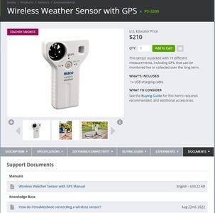

Also to assist with the use and setup of the sensor, I also need documents from the manufacturer which are:
  • Sensor user guide (in the 2nd picture): The reason I need this is because every product specification (like battery, number of data points stored, how to set up, and data format) is included in the sensor user guide.

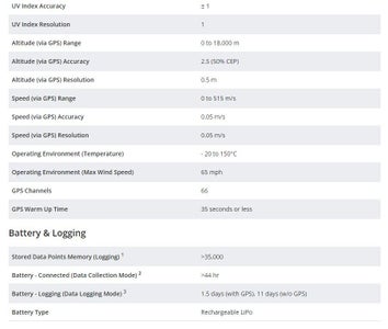

  • Thirdly, you must know the relationship between the number of measurements and Battery life. As you can see in pic 3, this PASCO sensor can collect a lot of measurable parameters. However, the more parameters I want to collect, the more the sensors have to work. Because in this sensor, it has small separate sensors just to collect temperature, and humidity individually. The more parameters we collect, the more small sensors have to be turned on in these big PASCO sensors, increasing battery consumption (as you can recall from the supplies step I provided the detailed structure of the PASCO sensor).
  • Finally, you must know when the sensor's battery is running low. Take a look at the 1st picture in this step, you see on the PASCO sensor, there is a Battery sign with a light next to it. So based on the user guide, it said: "The battery light will blink yellow while charging, blink green when full battery and blink red when running low." This is actually an application of Ergonomics to Product design.
In my case, this PASCO sensor can work for 44 hours in non-remote mode and for around 11 days with remote work. However, this only applies for all measurements enabled, meaning you measure temperature, humidity, wind speed, UV index, light intensity, GPS location,... (which is really unnecessary).

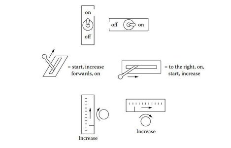

Step 4: Understand Some Basic About Ergonomics
Ergonomics is the scientific discipline concerned with the understanding of interactions among humans and elements of a machine or system. Basically, it will focus on how humans interact with machines, from there designing better machines to enhance the experience of the users. There are several aspects of Ergonomics:
  • Workplace Ergonomics: Workplace ergonomics is really about building a better workplace. For example in the 1st pic, you see 1 typical type of Workplace Ergonomics. By designing the setup of the computers, desks and chairs in a way that maximize workers comfort, the worker can work for longer hours without having back issues like before.
  • Physical Ergonomics: This type is concerned with human anatomical and anthropometric as they relate to physical activity. Products with this type of Ergonomics will design in a way to reduce the harmful effects they may bring to users. For ex, in the 2nd pic, you see an Ergonomic mouse will have a shape that better fits human hands and therefore reduces the pain from working for long hours.
  • Cognitive Ergonomics: This type is concerned with mental processes and how humans perceive information. Usually, systems or products with this type of Ergonomics will design the user interface, and buttons in a way that any user can immediately know the usage of those without much clarification or instructions. For example. take a look at the 3rd pic, if you see those types of buttons or knobs in real life, you will know how to use those without instructions like, "First, rotate the knob." or "First, slide the slider."...
Based on the thing we discussed above, the type of Ergonomics to be used in this sensor would be Cognitive Ergonomics. Because all the buttons on the software user interface and the LEDs blinking things conveyed a lot of information to us without the need to have numerous labelling or instructions on how to know or recognize them.

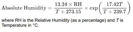

  • Secondary measurements: Each secondary measurement is a calculation based on one or more of the primary measurements.
Some PASCO sensors' secondary measurements are: Absolute Humidity (calculated from Relative humidity), Dew Point, and Wind Chill,... An example of Absolute Humidity was provided above to show how Secondary measurements can be calculated from Primary measurements.

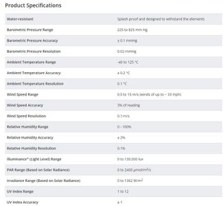

Step 7: Measurement Accuracy and Precision
First, we see in these pictures (pic 1 and 2) that for every value that the sensors are collected, there always ranges. I really want to use this opportunity to introduce the concept Limit of Quantification.
  • Limit of Quantification is the lowest value of a signal that can be quantified with acceptable precision and accuracy. Every sensor or method of measurement will have a limit of quantification. As you can see in pic 3 of this step, you will want your measurement to have values that fall inside the green region to have acceptable precision and accuracy.
  • For example in our case, we see that the Barometric Pressure range is around 225 to 825 mmHg. So if you measure with your sensor and it gives back a value of 200 mmHg, you will not use that value because it is well below the Limit of Quantification, therefore, the accuracy of the value is not true anymore.
Also, I do want to introduce the concept of Accuracy and Precision.
  • Accuracy: How close to a measured value is the true value.
  • Precision: The reproducibility of a result.
Take a look at pic 1 and 2 again, for ex Barometric accuracy is 0.1 mmHg. This means that suppose I know exactly the Barometric value of a certain environment is 250.8 mmHg. When I use the PASCO sensor to measure that environment, the value will either be 250.9 mmHg or 250.7 mmHg. It means that there will be 0.1 variations around the true value of the measurement. For precision in this case they didn't provide but you could do it by yourself. Just simply measure something 5 or 7 times and record those values and calculation variations and you could have a conclusion of whether there is the reproducibility of the result.

To turn on PASCO sensor, press the ON/OFF button until the 3 status LEDs shine momentarily. The purpose of the 3 LEDs is actually from the concept of Ergonomics. It allows the user to know the status of the sensor.
Take a look at the 1st pic in this step of the PASCO Weather sensor, you see there are 3 LEDs for Bluetooth, Battery and GPS. So based on our common sense, when we turn this sensor on, we expect to see green light blinking at these 3 LEDs. If they are blinking red, it means something wrong is happening with them.
