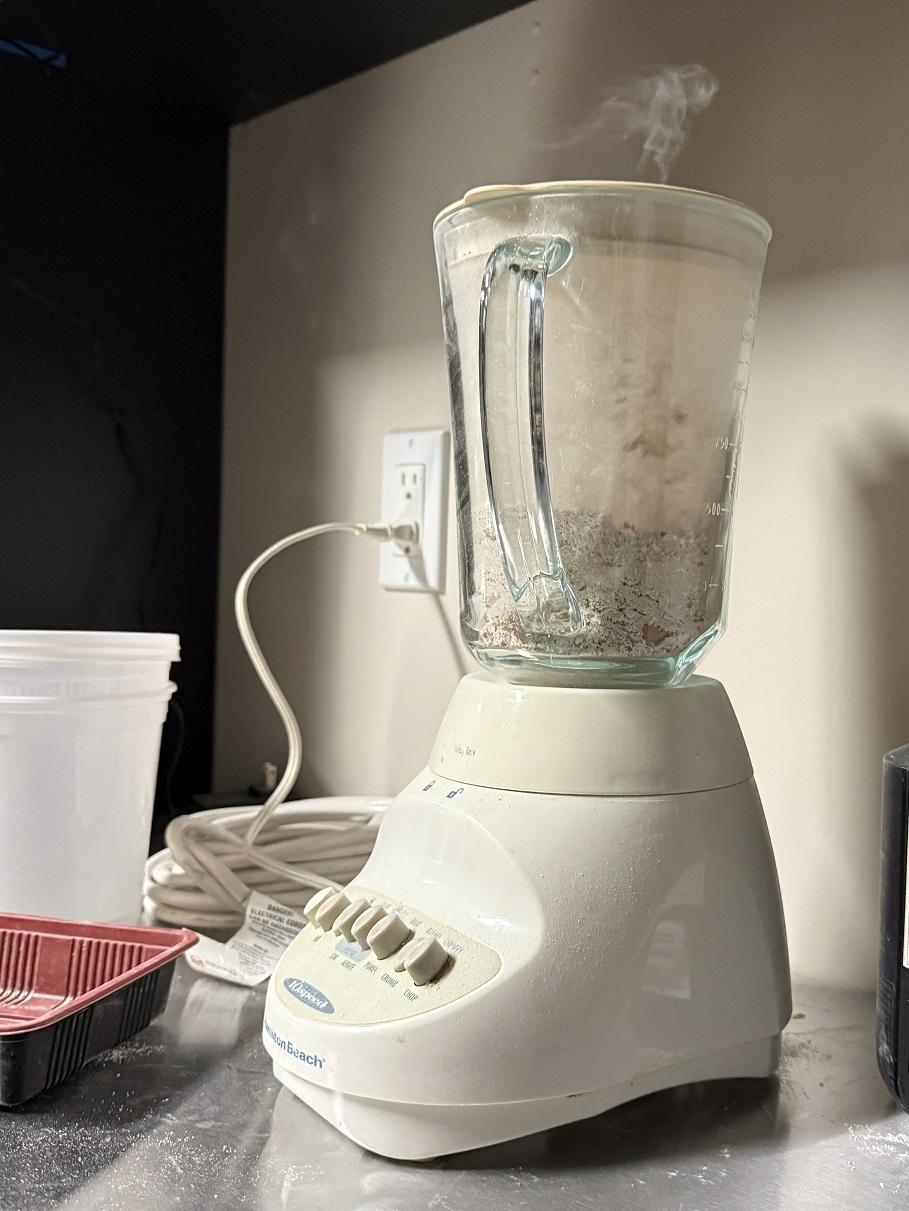

Step 3: Blend
Blend the eggshells until they turn into a fine powder. If you want an extra-smooth texture, you can sift the powder through a sieve.
Tip:
[1] Wear a mask while grinding—eggshell dust can get everywhere!
[2] Consider sorting eggshells by color before blending. This makes it easier to create ceramics in natural eggshell tones or experiment with variations by mixing different proportions. Even if you plan to add food coloring, keeping some white shells separate will help you achieve your desired shade more easily.
