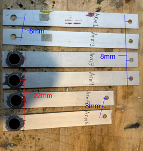

Step 1: Prepare Your Arm Bases
1.) Measure and cut your yard stick into 6 pieces, (4) 12in long pieces (2) 8in long pieces (you may use the cirular saw or bend the yardstick at the length continuously until it snaps (saw is preferred))
2.) Grab two of your 12in pieces and marl/drill both ends with a 8mm drill bit (make sure the holes align)
3.) Grab your other two 12in pieces and mark/drill one end with your 8mm drill bit and drill a 22mm hole on the other end with your step drill bit (make sure the holes align)
4.) Take both of your 8in long pieces and mark/drill one ends with your 8mm drill bit then at the other end drill a 22mm hole (make sure the holes align)
Materials/Tools Used:
Drill Press
8mm & Step Drill Bit
Compact Circular Saw
(2) Yard Stick
Sharpie
Ruler/Caliper
In total you should have two 12in pieces with 8mm holes on both ends, two 12in pieces with 22mm holes on one and and an 8mm hole on the other end, and two 8in pieces with 22mm holes on one and and an 8mm hole on the other end. Refer to the image for help.

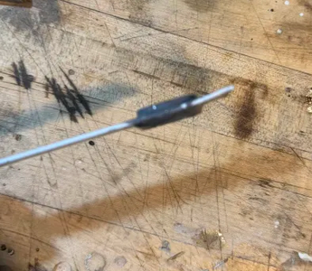

Step 3: Prepare Your Joints
1.) Measure your 8mm thick rod to the lengths provided below, then clamp the rod to your vise. Cut the rod with your compact circular saw to your measurements. Be sure you use eye protection while cutting and use hand protection after handling.
Piece I: 3.6 Inches
Piece II: 3 Inches
Piece III: 1.5 Inches
Piece IV: 1.5 Inches

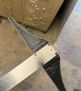

Step 4: Prepare Base (1/2)
1.) Take both your T-Squares and unscrew the top parts from the rest of the T-Square until you are left with just the top part of the T-Square and keep the access metal for later
2.) Clamp your T-Square heads to your vise and use your compact circular saw to cut the ends of the T-Squares. Make sure you cut them so the hollow side is facing outwards for both sides (refer to the picture for help)
3.) Mark and drill a 8mm hole in the center of both T-Square heads with your drill press making sure they align

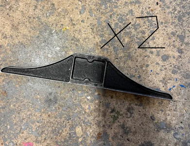

Step 5: Preparing/Assembling Your Arm
1.) 3D Print the following file (I highly recommend you print twice in case you lose some pieces)
The pieces belong to certain parts on the prosthetic, to assemble the build properly follow the diagram so the spacers are at the correct spots. You may use the diagrams or written instructions below
--Bottom Joint--
Use the 3.6in long metal rod, insert the following parts into the rod in order:
EP-1 -> T1 -> P1 -> Arm 1 -> P2 -> Arm 2 -> T2 -> EP-2
--Lower Med Joint--
Use the 2.5in long metal rod, insert the following parts into the rod in order:
EP-3 -> Arm-3 (insert trough ball bearing) -> P3 -> Arm 4 (insert through ball bearing) -> MP-1 -> Arm 1 -> P4 -> Arm 2 -> EP-4

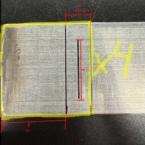

Step 9: Arm Attatchment
1.) Get the spare metal you got from your T-squares and mark/measure them to the diagram above
2.) Put the metal on the vise and make your 4 pieces with your compact circular saw (use hand and eye protection)
3.) Cut the middle slits with your dremel (use eye protection , the blades tend to fly off) and find your handle (the prongs should be about 4 inches apart)
4.) Clean all the pieces and the handle with alcohol and steel woll
5.) Elevate the arm contraption and glue your pieces to the end of your metal L-trim beams with epoxy so that the side with the slip is sticking out then clamp
6.) With your elevated arm contraption lay your handle at the front of the arm contraption and move the other arms out of the way, clamp something underneath the handle so that it sticks out of the contraption then glue the corners with epoxy
7.) Measure and cut 2 strips of Velcro (add 5 inches to your lower and upper forearm length) then slide the Velcro through the slits in the metal
