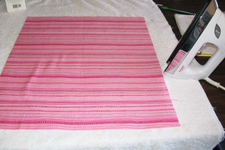

Iron the fabric pieces flat. Then, fold the fabric over so that, when folded flat, the folded area is 3" taller than the tallest of your devices. Cut out a piece that's the width of the inside of your bag PLUS 1" and the height you just determined. (In my case, this was 13" wide, plus 3" for the side flap, plus 1" {17" wide} x 5" high.)

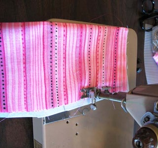

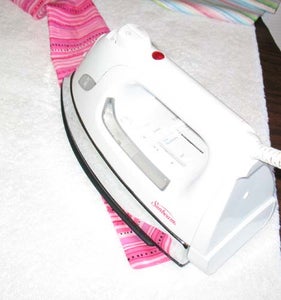

Place the interfacing on top of the folded pocket strip. Sew one of the short sides of the strip and the long side. Turn the pocket strip right side out and iron flat.

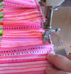

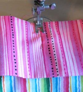

Carefully, sew the pocket strip to the backing. Sew along each pin-marked pocket line, removing the pins so your machine doesn't get damaged.
Sew down one short side, taking out the pin before your sewing machine hits it. Then, turn and sew along the long edge, easing the wrinkles and extra fabric of the pocket strip into the shorter length of the backing. Larger devices (like my camera and wallet) will require taking folds in the pocket fabric. Sew up the second short side, removing that pin as well.

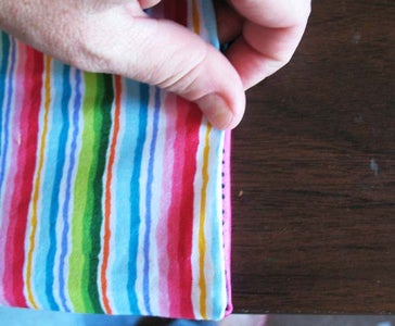

Fold the backing over the pocket and sew one short edge and then the long edge. Be careful as this can get a little thick. Turn the tube right side out and iron flat. Test to make sure everything fits in its pocket.
